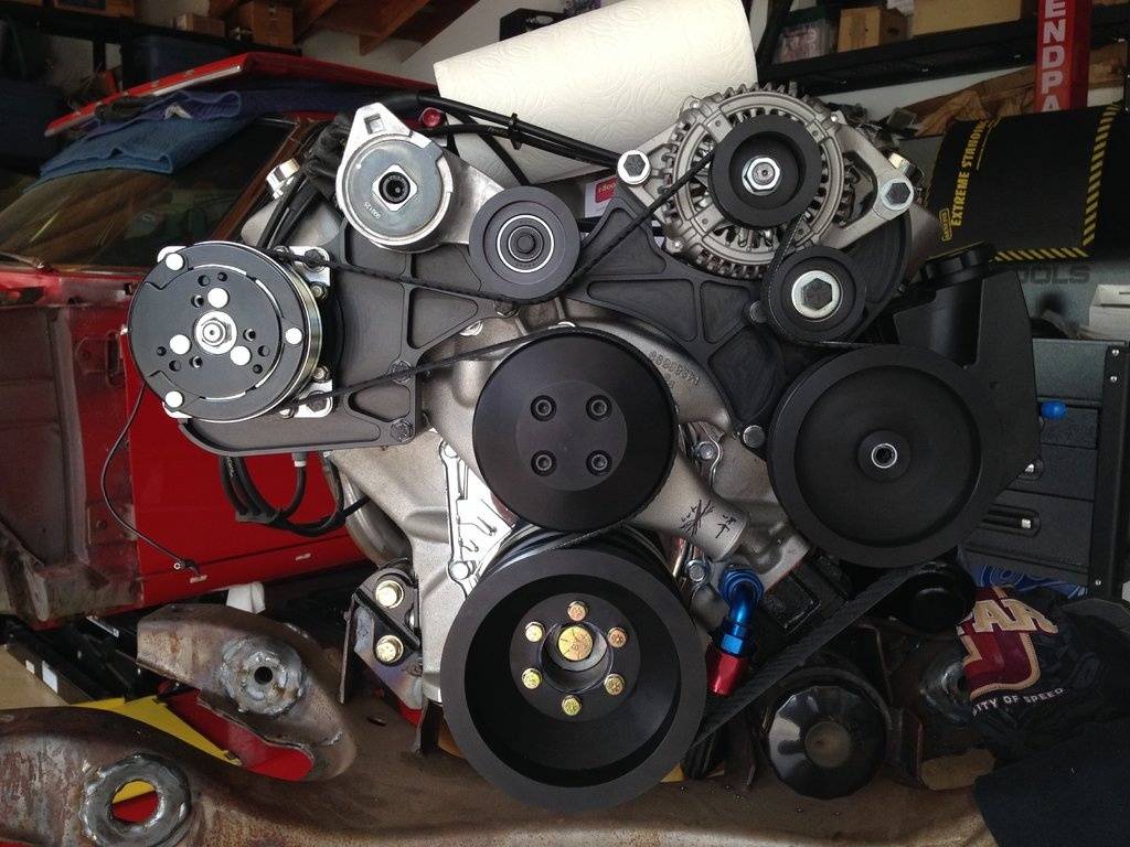

For my serpentine system, I got the one from SD Concepts. Jerry is a Mopar dude. His set up uses readily available accessories, which is a plus if you breakdown on a sunday in a rural area, and does not look like something designed for the transformer movies. sdconcepts.com
I have looked at this system and talked with Jerry. I am also looking at the all inclusive system by CVF Racing - https://www.cvfracing.com/Serpentine-System-for-Big-Block-Mopar-383-426-440-p/440-wraptor-ac.htm . CVF racing is now offering the system in Anodized Black as well and overall it's less expensive than SD Concepts. It's a hard choice, but it may all come down to budget and the CVF racing setup also includes the water pump housing and pump. I have to say your engine pic looks mighty good though with that setup !

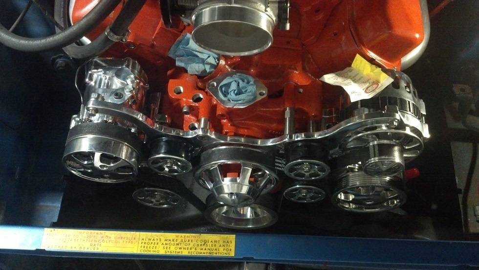

That CVF racing system looks like a copy of the Billet Specialities setup.
Several years ago when there was not much out there, I got the expensive Billet Specialities setup. Overall I like it, but the remote reservoir power steering is alot of extra plumbing. I also added a power steering cooler while plumbing in the remote reservoir. The other thing is the brackets and pulleys move everything forward, so there is not much room between the waterpump pulley and the radiator.
I really like the clean look of that setup. I have pulled the trigger on the CVF Racing Racing and hopefully will not be regretting it.

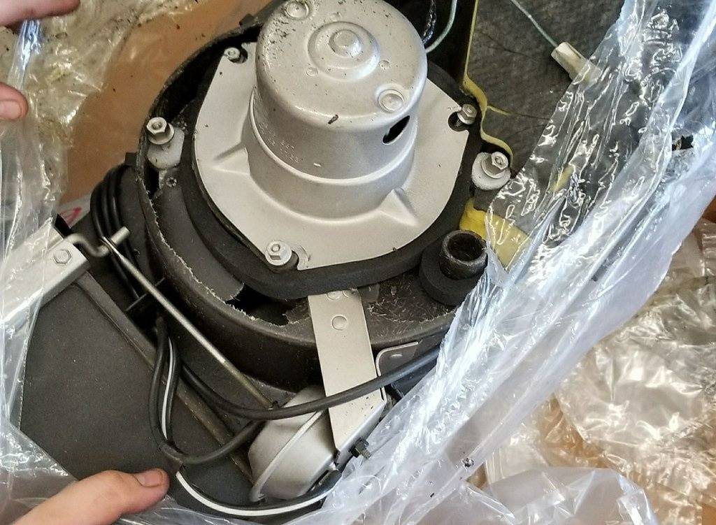

Well I got my restored AC Box last night. However, UPS did a real good job of packing it and this is how it arrived:
My day has been ruined over this.
