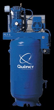

I own a Quincy like this:
Its very reliable.
