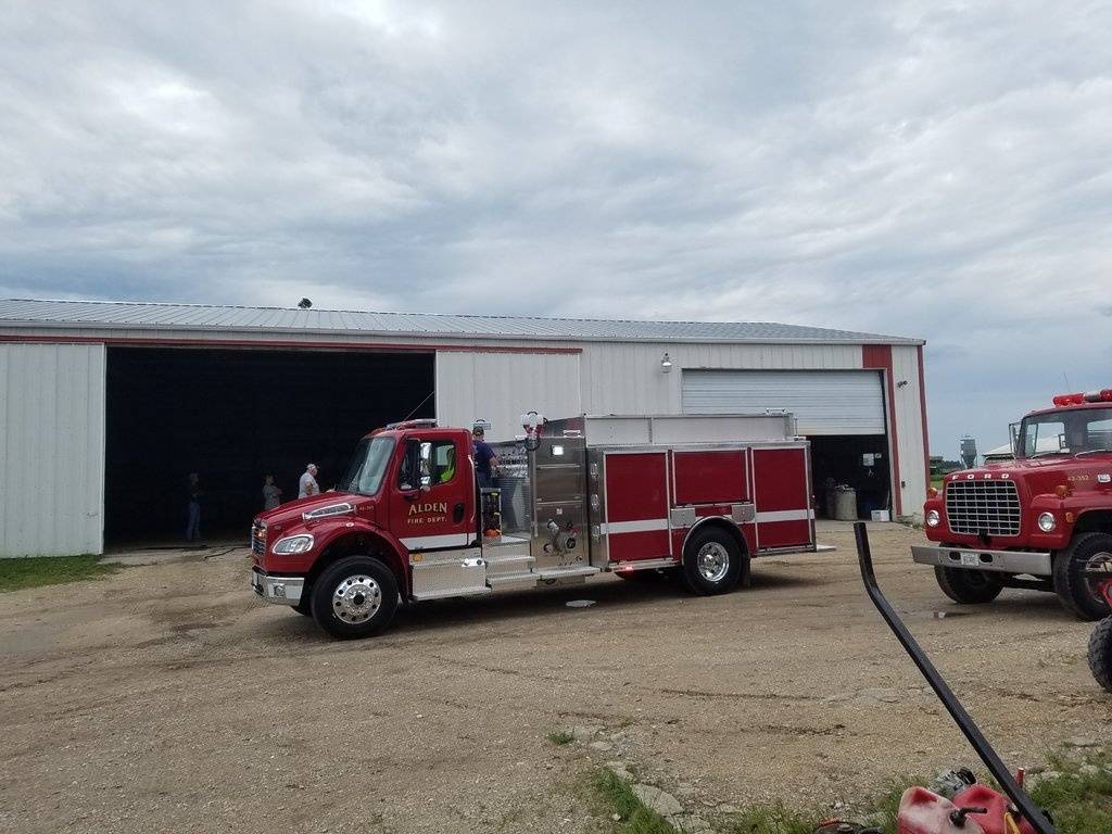

Meanwhile my brother calls our mechanic who is a volunteer Firefighter for a different township. Fifteen minutes later the Fire Dept shows up. Our mechanic personally telephoned members of the nearer Alden FD (hes Bradford FD) and they came. By then we had extinguished the flames. While my dad and brother were trying to get help so took it upon myself to grab the water wagon and pull it next to the shop. It hold 3000 gallon and has a 200gpm pump on it.

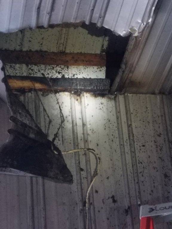

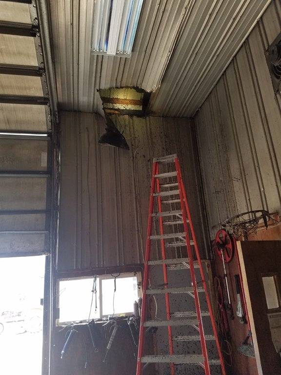

Damage was minimal. I will need to splice a sister board alongside the charred header, replace a piece of ceiling tin and blow a bunch of new insulation up top. And of course pipe and rewired from the switch back to the breaker box.

what do you suspect happened?

This shop fire almost certainly has to be from a mouse chewing the romex given the location. The melted wire is away from all fasteners and bends in the line. It was in a straight stretch.
