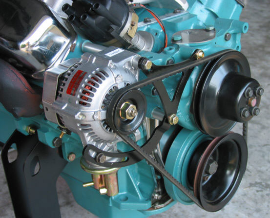

cool, I was just looking at that same Mancini page yesterday. I think it might even work with my current brackets if I just order the alternator by itself shown on the bottom of the page (P/N MRE6659). I just need to call them to see if this Denso 60A alternator has an internal regulator or not.
Well I called Mancini again Friday and the Denso 60A I was looking at is indeed internally regulated and is a 3 wire, so it looks like it would work great for what I'm looking for, however, it won't bolt up to my car without a special bracket which they don't sell. However, the rep told me that Jeggs and Summit carry the bracket. I think I found the correct bracket online, but I need to call them and verify. The saga continues....

Try an alternator from a 1988 Fifth Ave. It is called a 90amp square back and would fit.
a GM Alternator on a Mopar ! :head_smack:......That's like a Blow Job from your cousin, ...it may do the same thing, ....but it just ain't freakin' right ! :no:
Yeah but she swallows.....well that's what dad and my uncles reckon anyway.:tongue8:
Back to the issue at hand, my car had a GM alt on it when I got it, it just looks wrong.
I'm going with a mini Denso alt with mounting kit......yeah I know, but at least it kinda looks like the Mopar birdcage unit.
