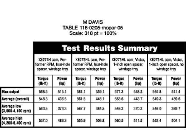

Found this article last night which is almost identical to my build... I would be pretty happy with these numbers...
://www.google.com/amp/www.hotrod.com/articles/mopar-440-update/amp/

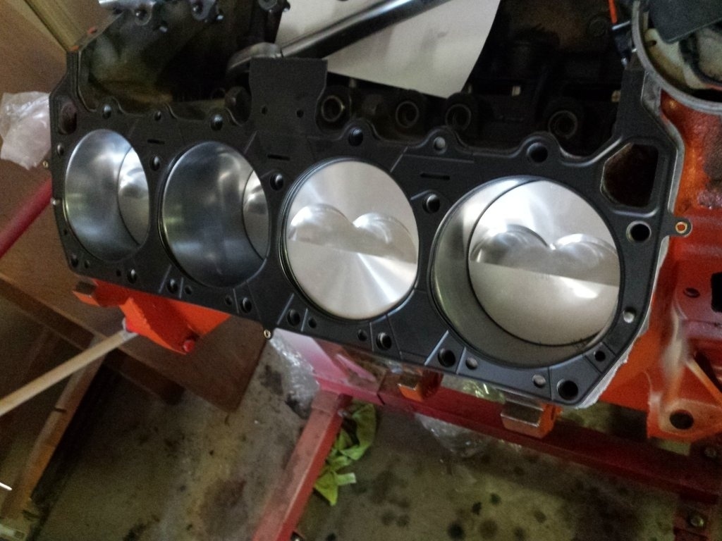

FYI, the KB236 pistons are stepped pad pistons so if you run a closed chambered head such as the RPM's the pad will need to be milled down. Same piston otherwise as the KB 237 which is a flat top.
I wondered if I might, even though I have the 84cc heads. It's not a big deal either way as I was going to tear the motor apart to have it cleaned anyway, and a friend owns a machine shop across the street.
I'm still unsure of the piston( I can't read the number on them). So the only thing I was going off of was the step measurement .075,/ CH 2.067, but the part I'm missing is that the 236s show valve reliefs, while mine has a trough like the 184s which show to be .140/1.992.
Either way I can make it work with and get very close to what their set up is with minimal effort.
Yea, the 236 and 237 have symmetrical valve cuts. Probably different ones then. Mine are set .009" in the hole, no decking done.
