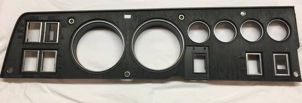

Just finished restoring may dash- used "chrome" pens from MOLOTOW LIQUID CHROME.
Easy to use and great finish.

One swipe, dont touch it again until 12-24 hours later- you will make a mess- practice on the back of the bezel- make sure you shake the pen as instructed and get extra nibs (tips)- if you touch a black area you can wipe it of and retouch once fully dry- Get the 4 mm tip and a 2 mm tip- you can get extra tips and cut them to suit your angle- it worked very well for me- you need a steady hand.

Based on what you can tell from this picture, would you guess a 2 or 4mm?

Just got my pen yesterday and used it today. It's the closest thing you can get to rechroming. Hard to tell it's not chrome.
