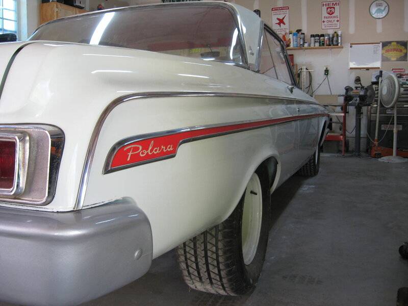

Back in the day, I had H 50's on 10" rims, on my '64 Polara500. No rub. I'm not sure what the back space was or what the equivalent size would be for the newer tire sizes.
Edit; Looks like the "H" tire size is a 275 today.

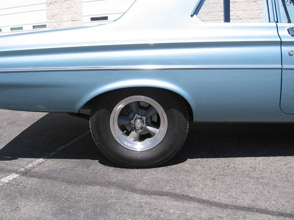

According to Tire Size.com a BFG 275/60/15 is 28'' tall,wide 11''(that is to the sidewall to sidewall, tread is 9.5'') Rim range is 7.5 to 8.5. I have them on my 65 Belvedere. Only photo I have,they don't rub..You may be able to get(if they make them) 295/60/15 that should get you 30'' tall and 10'' to 11'' of tread. I'm sure they would rub the outside of the wheel house.But maybe not.

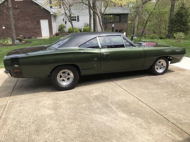

That sounds like a great size for the rear tire. I have 29x12.50x15 M/T now and they sometimes rub the fender lip. These may give me just enough room, but I’m not sure about the front tires. 27 inch only comes in 8 inch width, tops. Seems a bit skinny for my taste. Would a 28x10 be too wide and or tall?

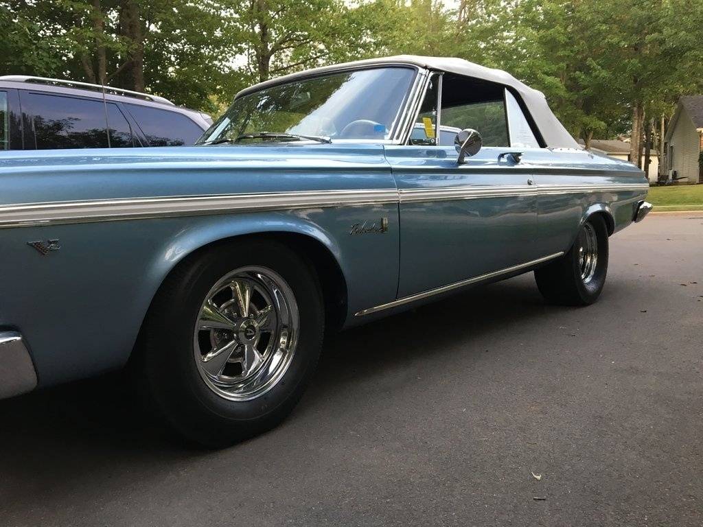

from Highway Star.

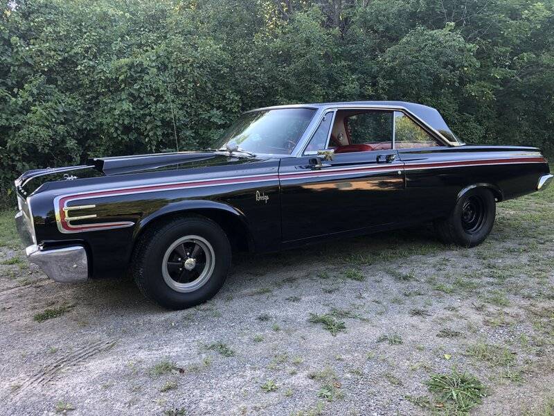

295/50 15 on an 8” rim. Like the cartoon look.

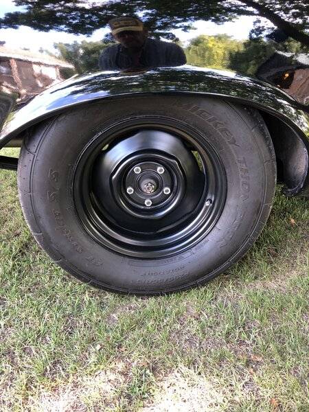

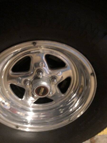

Wheel width is 8". Back space is 5 1/4.
Tire height is 28" x 11.9 section width x 10.59 tread width.
all fits in a stock 64 b body quite nicely. Not sure about a 65 Coronet..
Hope this helps.
