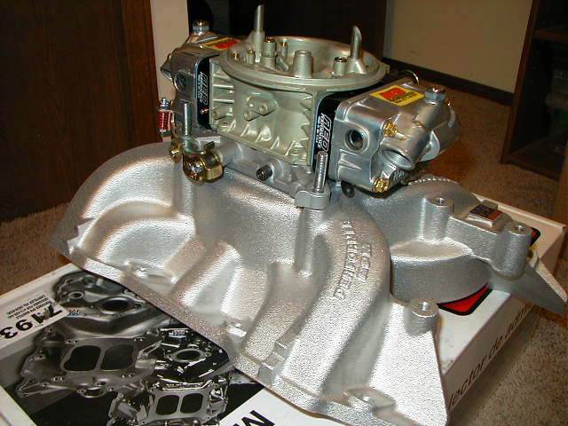

Carb for a mild 440 suggestions
If budget allows, might be worth giving AED Performance a call. They are extremely helpful with finding something for your exact application... Or else give em a call and see what you can find out. Good luck, sounds like a fun combo
That's what I did and could not be more satisfied. Perfect match.
I've run numerous 3310's & 750 DP's on my 440's and an aftermarket Carter AFB( which seemed to be about the same as an AVS). The 750 DP can work really well, but will likely take some tinkering with the acc pump cam & shooter size in addition to the jets (stay close to stock jet size). 3310's work well also, again tinkering is likely needed with the secondary spring, shooter & acc pump cam. The 750's were always a little "crisper" once I got them optimized. A 650 DP would probably work just great too. The Carter worked great on my 360 when the carb was new, but it did "age". Doesn't the Ford kickdown on the 3310 just unbolt?
