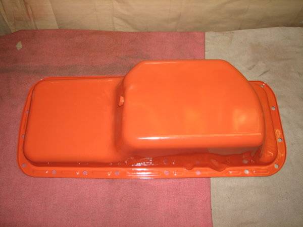

I almost 100% sure the Hemi And 440 6 pac had the same pan. No numbers on it.
Milidon made this one.
Hey Brian, I think that's the pan I'm running now. Just a heads up, I tried to run that Milodon pan with a factory hemi 1/2" pickup tube & it wouldn't clear. It seems like you have to buy pans/pickups in "sets", so I went with a 1/2" Milodon pickup in my current motor.
I still have that factory hemi 1/2" pickup somewhere if somebody is looking for one & has a factory hemi/six pack pan, fyi.
That's odd because my friend had a factory pan and I had to look at it to make sure it was the one I needed for this hemi we were doing and when I got it from milidon we put them side by side and they looked identical. The pick up did come real close to the pan even with the 2 gaskets and windage tray so I took a tap and went in a turn and that gave me the extra clearance I was looking for. I think they make them a little long so you can set your gap better by threading the pipe or block or both.
