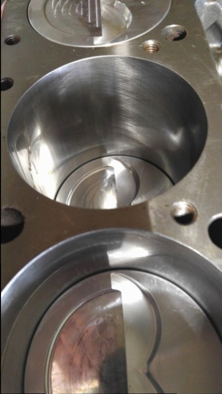

Here are a couple of pictures of the engine. Trying to make it look "close" to a stock 426 street wedge engine. Peak HP @ 5800 rpm 683 and max torque @4600 rpm 688 ft/lbs
OEM 440 block
ARP Main studs
Molnar 4.25 crankshaft with 2.200 rod journals
Autotec Custom pistons 4.380 bore 10.96 compression zero deck
Custom Hyd roller cam
Morel Hyd rolleer lifters
440 source heads 2.140/1.81 valves CNC ported Max wedge intake window. Inntake flow [email protected] lift exhaust flow [email protected]
Indy 440-14-2D dual plane intake port matched
Holly 950 Ultra HP 0-80805BK
PRW Roller rockers 1.6 ratio
Melling HV oil pump
street hemi oil pan with Milodon windage tray 32000
Dougs headers D452
