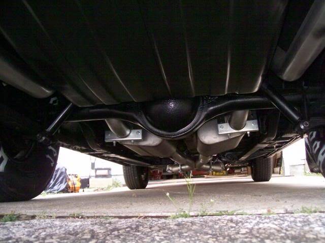

I dont run any on my 63 Sport Fury and I thought about the factory ones the Max Wedge had. But I love the sound of a nice solid flat tappet through the sound of a closed exh system. So I went with the TTI 3" X-pipe and Dyno-Max Ultra-Flow mufflers since they look to be about straight through. I just race through the pipes which is the full exh system. But that way I can tell someone what my car runs just the way I drive it. Ron
