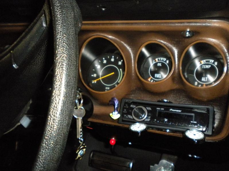

:iamwithstupid:...Hi guys...is a dimmer switch hard to replace? My brights speedo hi beam light will work but I have to pump the dimmer switch 20 times so I'm thinking replace the switch and pig tail...yes? no?...whatcha think? Marla...PS the photo has nothing to do with this topic but I had to show you where I put my new Bird Head...
