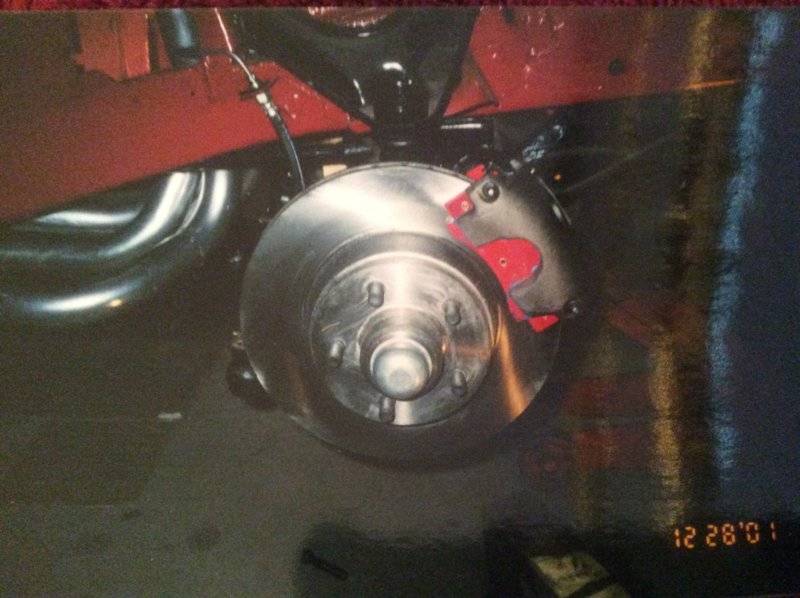

Ed are you talking about pinned calipers, like E berg did? Big dollars now. Did mine in 2001 $550 to $600 then.

Ed are you talking about pinned calipers, like E berg did? Big dollars now. Did mine in 2001 $550 to $600 then.View attachment 749718 View attachment 749720
