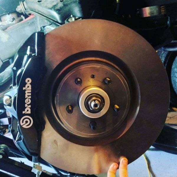

Drum spindle BIG disc brake bolt on, 6 piston, 4 piston, 2 piston.
5:57 AM
Dec 9, 2017
18
19
Hawaii
Like the title says, ive figured out a way to bolt on 15 inch 6 piston brembo brakes on to stock drum spindles and drum hubs on the 64 through 74 mopars. Biggest is the 15 inch 6 piston setup, next size down is the 14 inch 4 piston. Both of those are brembos off a gt500 Shelby.
But the cheapest setup is the 13.2 inch 2 piston brakes which can be found for $150 for calipers and rotors.
I have a setup for the rear as well, bolts right up to a Dana 60 or 8 3/4 rear end with 11.8 or 13.8 rear rotors and the single piston caliper has a built in parking brake.
Yes, I do sell the adapters. If you need some, hit me up, lots of people already have them and are using them.
This thread is about the conversion itself, pictures of installed brakes etc.

I get that question a lot and the answer is no... 16 inch wheels are a minimum when used with 11.5 inch front rotors and 11.8 rears, sorry.
The factory disc brakes are really affordable and I would honestly do them if you insist on 15 inch wheels. Granted, these are MUCH cheaper, but they just don't work with the older smaller wheels.

Any idea what size will fit with the Year One 17" alloy ralley wheels I have on my Challenger? I am also working on a d100. I know the hub wont swap on it. Has anyone had success having a rotor cut down to just a hub and using it that way?
12.4 would be your best bet on the rally wheels, although most 17 inch wheels fit the 13.2 no problems. The straight spoke aluminum wheels with a thick cast rim have issues with the 13.2... especially straight spoke style wheels.
