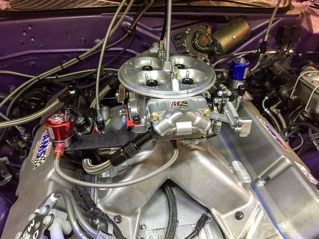

My plan is to make a pass NA first to see if the plate messes with the signal which I suspect it will because of the cloverleaf Manifold design. I am guessing I'll loose a 1/10th ET and a couple MPH. If I get brave enough to spray it will only be a 100 shot. I'd think 9.60-9.70 is pretty realistic. But who knows.
I know it's not a apples to apples comparison but my 69 RR had a 150 plate system, would knock .4 of the ET in the 1/8
When I had 440 in I gained over a second with a 125 shot. It runs great NA and my plan is to stay that way. Have an air strip race coming up where if I dip into the 9's I won't get in trouble. After that though the carb goes back on the Manifold and stays there. I like just adding fuel.

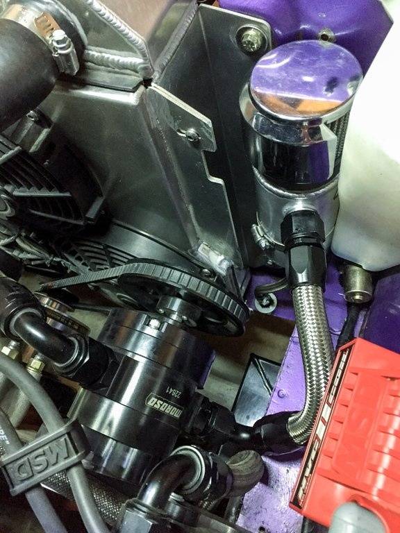

On another note anyone have experience with vaccum pumps? Mine works great. Only issue I seem to be having is the little oil it's pulling seems to want to go straight out the breather on top of canister. Is there a recommended way to mount the canister? A certian length of hose? Right now it has about an 18" hose with a 90 fitting on each end. Does it need a straight shot, a longer hose? A shorter hose? Ideas. Thanks.

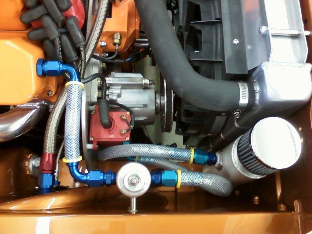

Mine pulls at the upper inside corner at the front wall of the valve cover. No baffels. It'll go 25 passes pulling about 2oz of oil.
What is that extra thing after the valve cover? A regulator or something?
Yeah. It's pulling about 13.5. I believe that is in wet sump range.
I put a shield off a valve cover breather on it. Also have a line running to rad support with a cap for easy draining.
