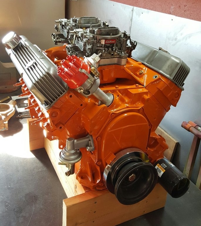

As Moparnation74 said, if you use ceramic engine paint, no primer needed as long as its really clean. That's how I did my motor after it was broken in by my builder. Then just covered all the openings, I used a kit that DMT sells, and used old plug wires over the plugs and painted it on a nice calm and warm dry day!
Damn...That is NICE! Good job

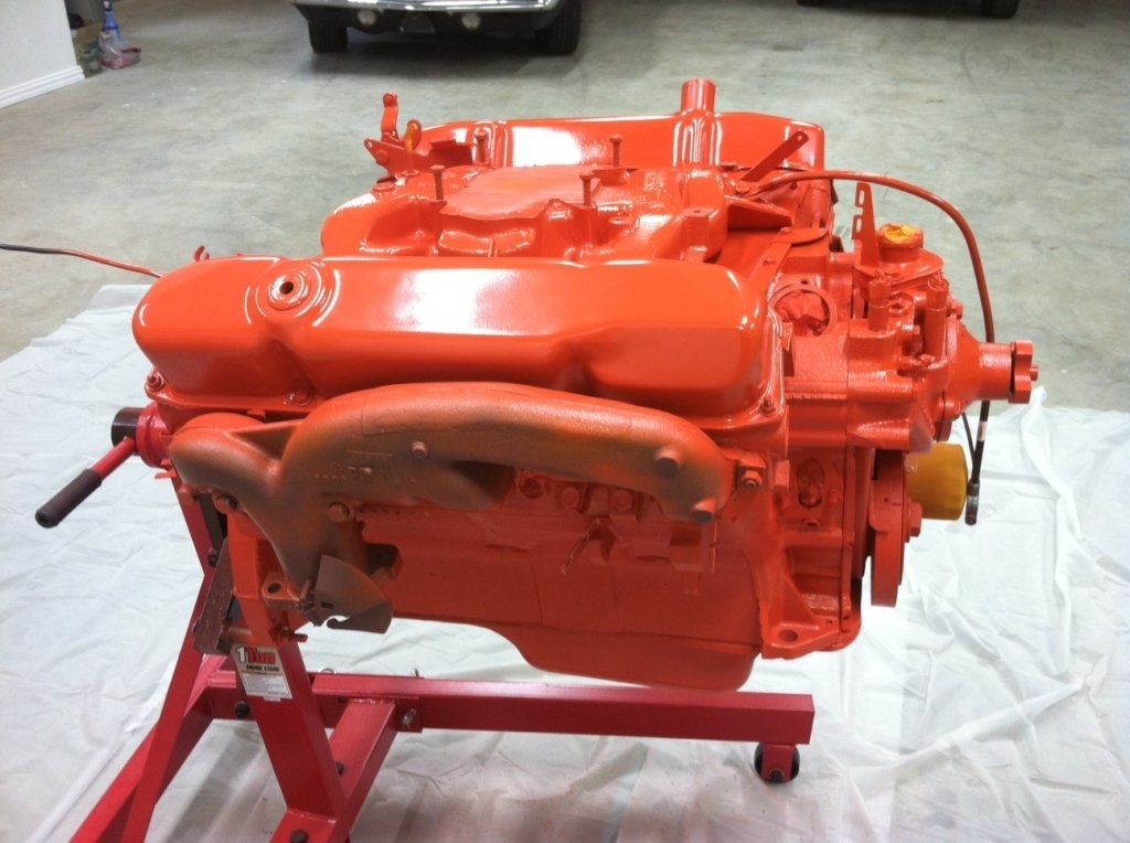

Here is a pic of my chargers original 440 Sprayed with Totally Auto's paint

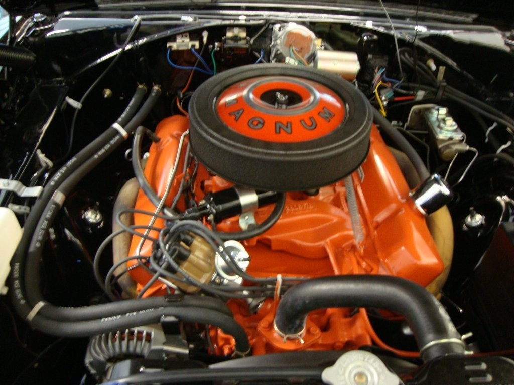

Want to do it really nice so it last's for years? Single stage urethane with epoxy primer. This motor has 400 passes and was painted 5 years ago.
Doug

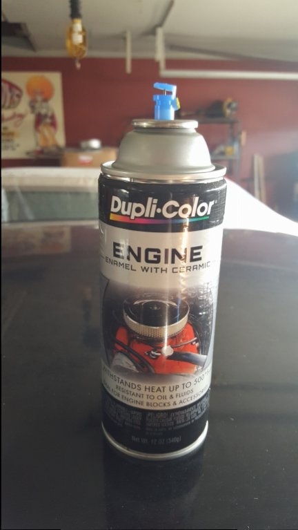

I bought a case of Mopar brand 70's blue as pictured above.
It has an odd sweet smell and is particularly sticky yet easy to run.
It also has a propensity to leak from under the nozzle, fill up the low area on top of the can, and then drip and run out.
Be SUPER careful that pool of paint doesn't drip on your work piece.
This has been an issue with all four cans I've used so far.
Not nearly as nice a painting experience as Krylon or even cheaper brands.
...but it IS the correct color.

I didn't have any problems with the nozzle dripping on mine but I know what you're saying. I really hate that and didn't know they had those nozzles when I ordered them. The sweet smell is quality paint. I'm not sure what it is, maybe added polymers but every car that I painted with quality brand paint had that smell. Cheap paints would smell like kerosene.
I believe Sherwin Williams had the patent on the blue nozzles and they are the best rattle can to buy. Always good paint in the can also.

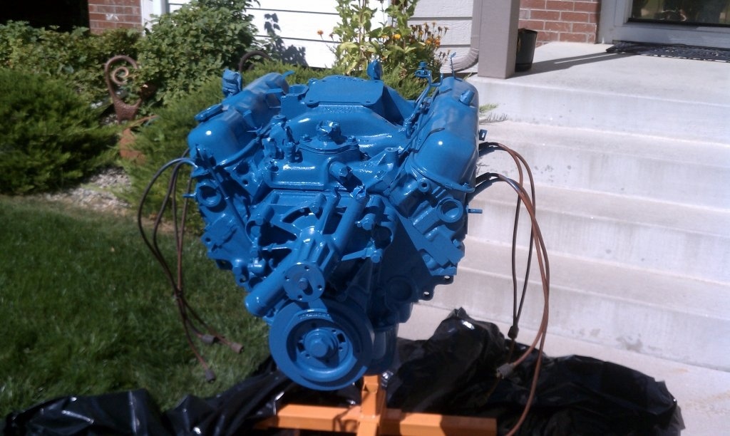

I have had rattle can paint on mine over 5 years on the charger. My previous rides had been around 10 years old on the paint and looked no different than cars with the same age and Badalson's paint. There are a lot of factors other than the paint that play into the life and duration of that finish.....
