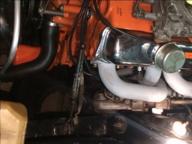

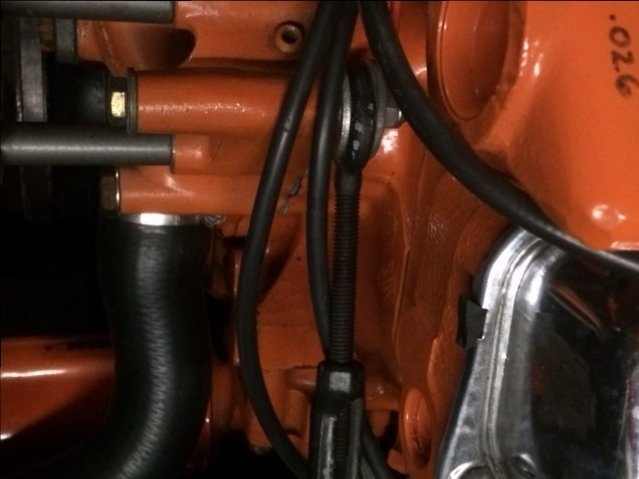

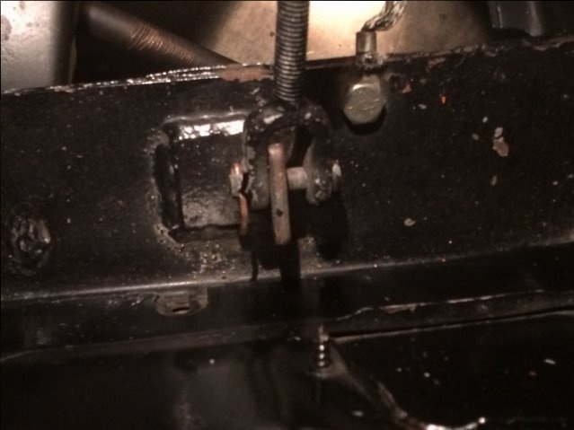

Hi Mike, never had any problems, for years same set up motor making close to 825 hp at the flywheel. strap is a 1/2" stainless steel with two hyme joints (fancy turnbuckle.)
street/ strip driven motor don't budge. i would preload the strap slightly since its sitting on the rubber mount

Hi Mike , running standard rubber mounts only thing I did to them was run a stainless steel countersunk 1/4 20"bolt though them with a nylock nut on the motor side of the mount to keep them from separating. but the strap took care of the movement.
Mike, the very set-up that you describe has been in my car for 40 plus yrs, 426 hemi, 4 speed, 5.38 gear, side step the clutch @ 6000rpm, 10.5 M+H slicks, man, you talk about **** happening quick, shift @ 8300,(yes you read that right 8300), never had any kind of a snafu with my tourque strap. A large alumiman turn buckle!! looks woefully inadiquite, but held that hemi fine. 'bout a week ago installed a 509 rb in the same car, guess what I put in for a strap? yea, that same turn buckle thats been there for 40 yrs. Dave.

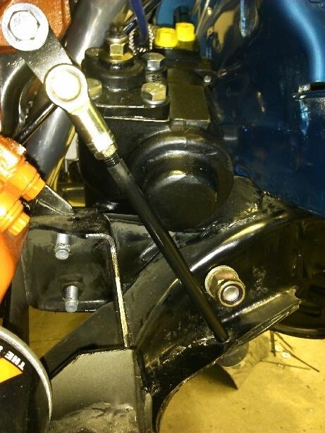

Mike here's the one I made for my car. Came off motor mount bolt. I used a rubber sway bar bushing to kill some of the vibration but in your set up you could a poly one to avoid squeaks.
