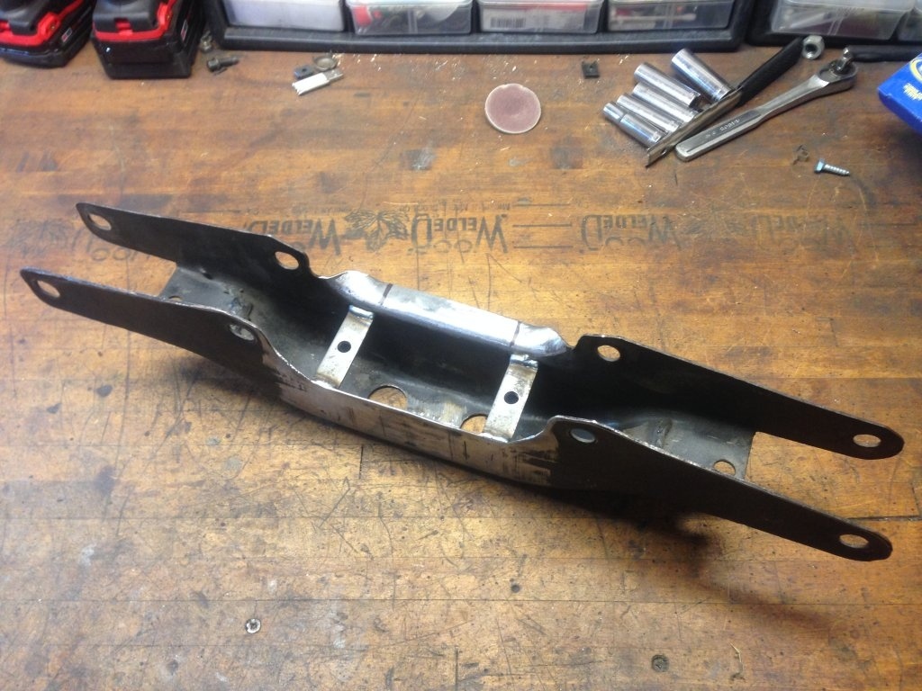

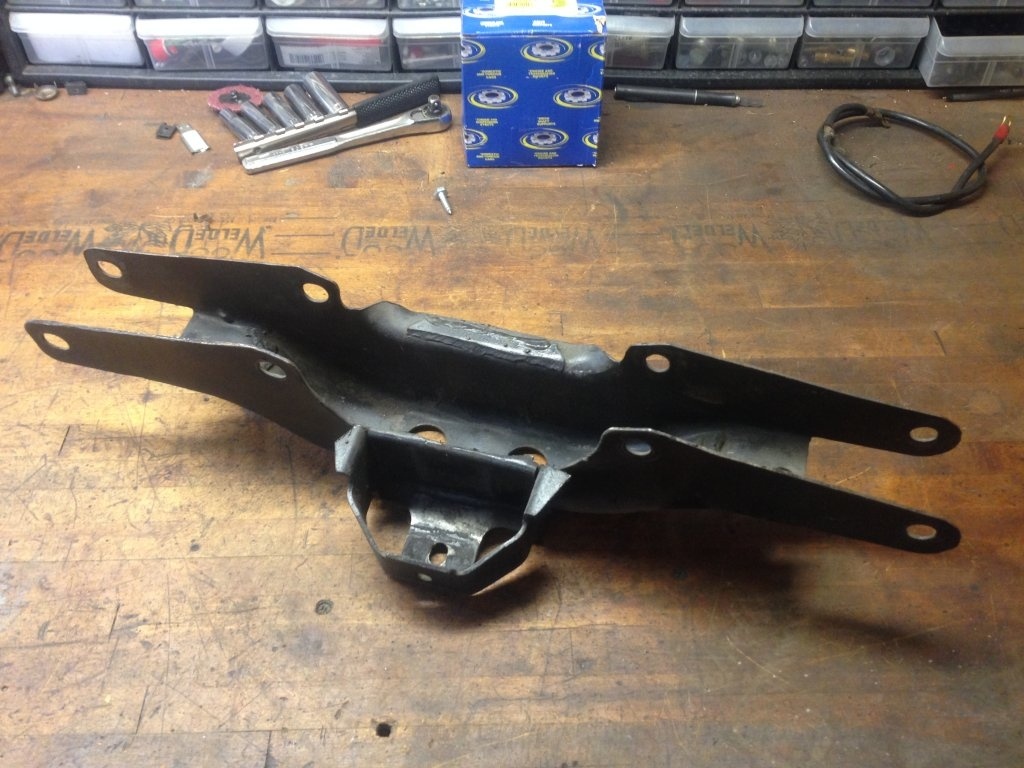

Looks like someone got to my crossmember before me! pretty bent, cut up, and mangled. I cut off the "rewelded" auto trans mount, bent it back into shape and put in some supports. Will be blasted and painted soon.

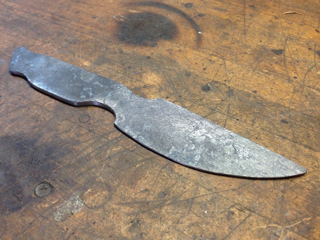

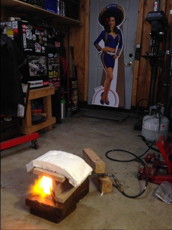

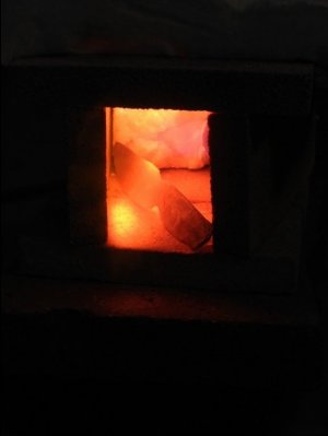

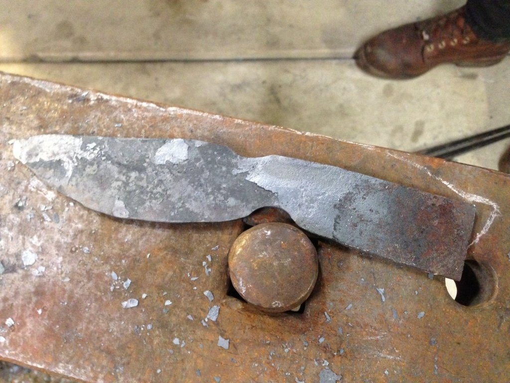

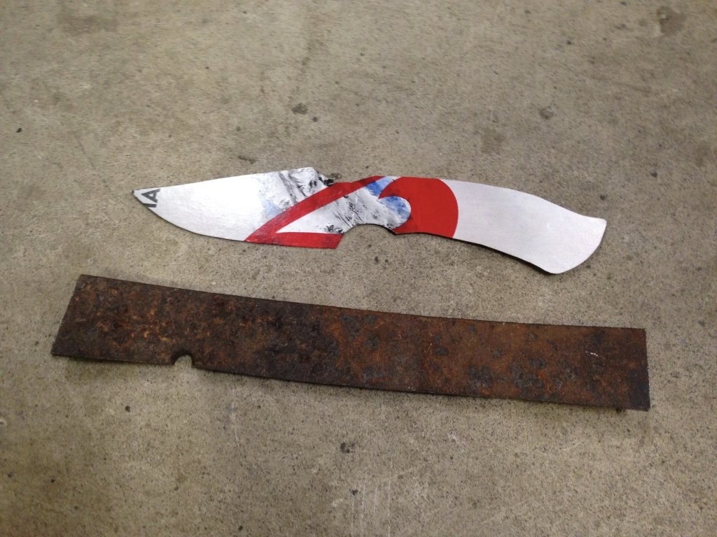

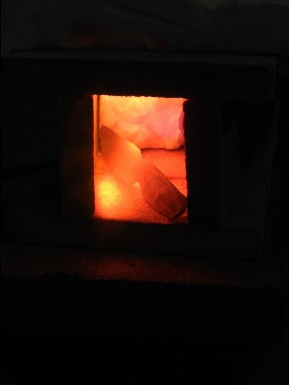

Thought you guys might get a kick out of this. My buddy came over with his makeshift forge setup and some scrap steel. We doodled up some templates and went to town on my old anvil. Pretty cool to learn the process. This is were I'm at after some tacos, beer, and a late night of pingin away. I uses an old leaf spring off a truck.

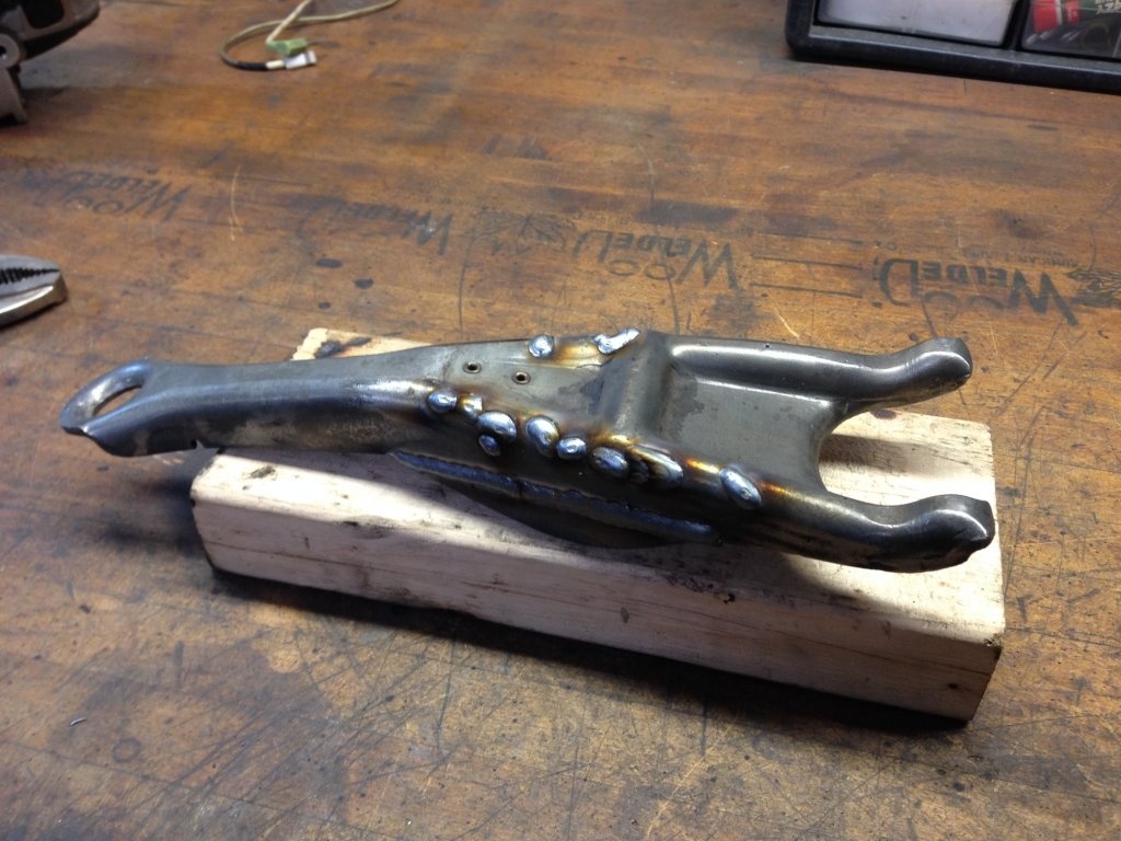

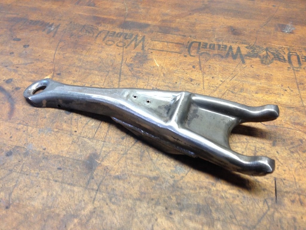

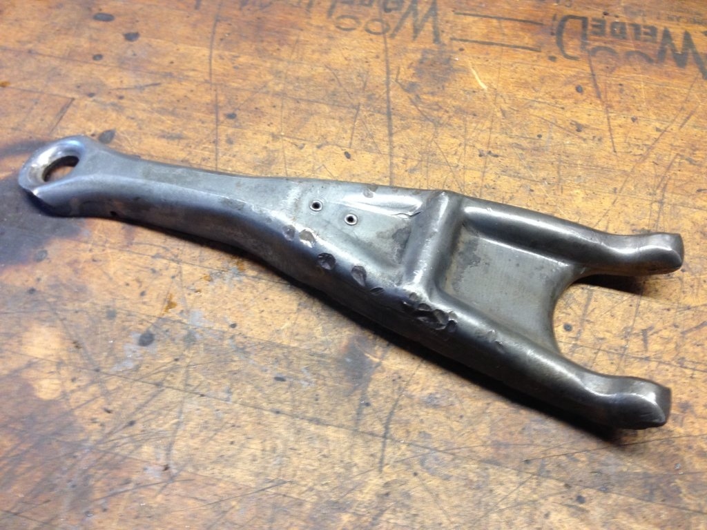

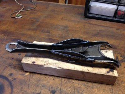

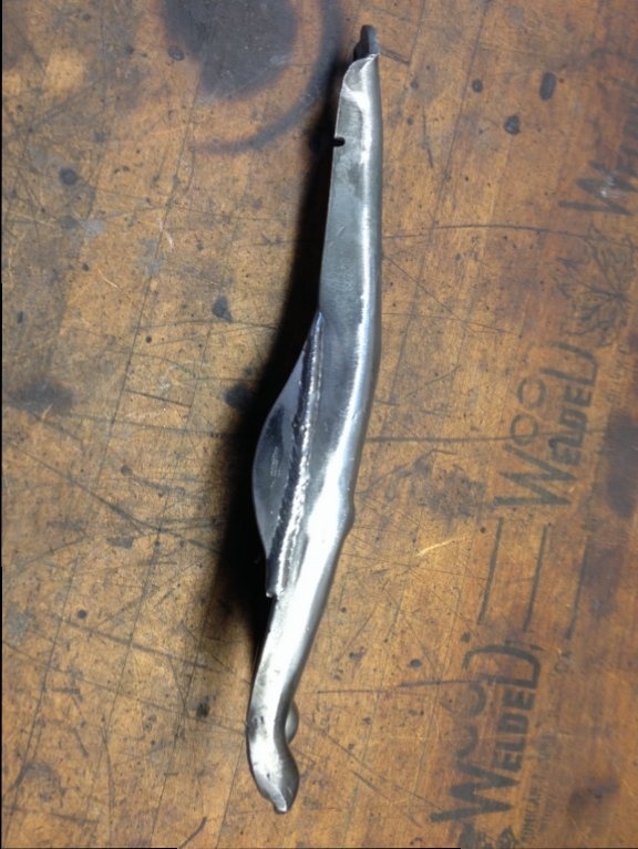

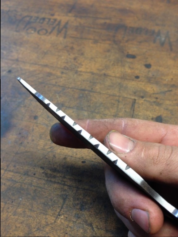

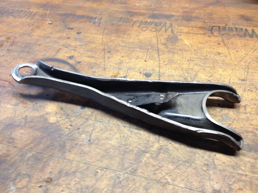

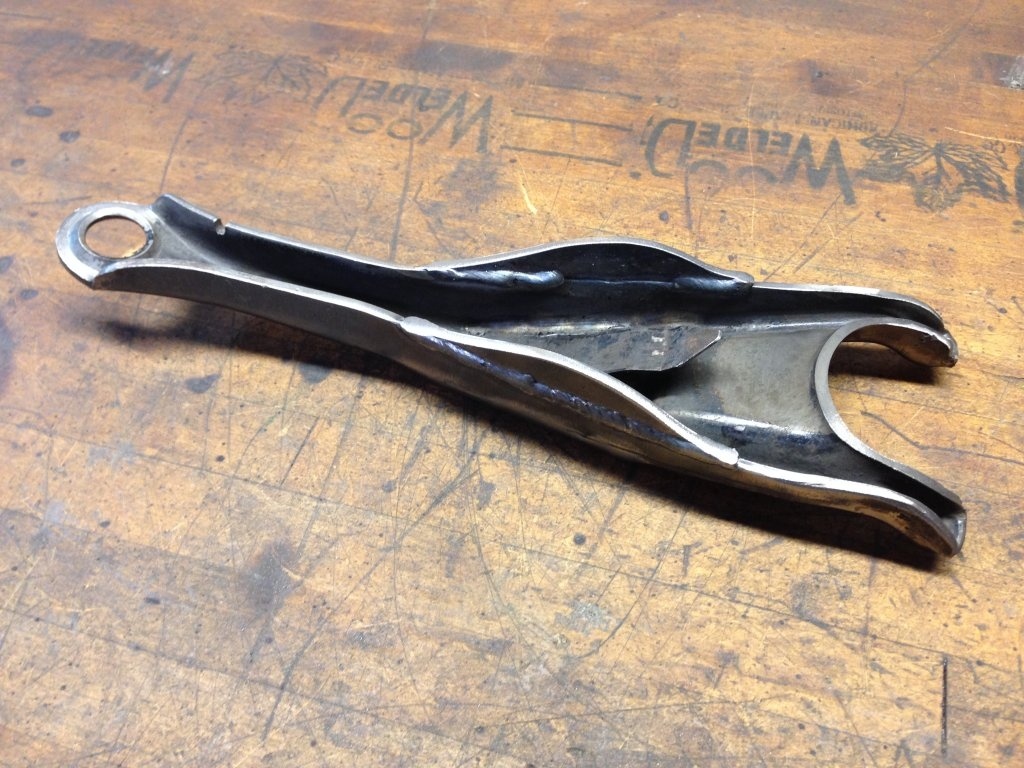

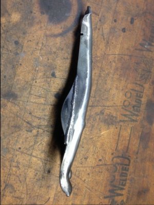

Fixed my clutch fork today. Someone trimmed it down for some reason... my guess is rattling or clearance...??? Anyhow, I took measurements off another fork to fix it. Took a bit but probably will be one of the strongest one out there! lol
