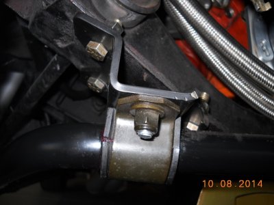

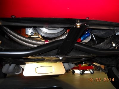

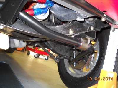

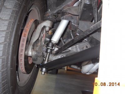

Since this was posted in the 62-65 forum I'll respond. My 63 Fury didn't have a bar. I purchased this from Firm Feel and am very happy with the fit and finish.
Hey CO Dave, please tell us the before vs after details regarding the FF bar. Did you end up using a rear bar as well?
No, I don't have a rear bar. My car is set-up more like a drag car verses road racer. 12" wide rear wheels and 5" wide fronts, Calvert mono springs and Competition Engineering bars. Although the picture shows KYB shocks, I switched to Viking double adjustables front and rear. I didn't like the body roll taking off-ramps and now that problem is solved.

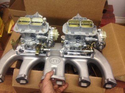

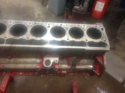

just got the the summit one today , saturday project , installing it and the rest of the suspension ,while the engine is being bored .060 over and the head shaved .100" that should bring up the compression a bit
just some random pics. I'm getting my sure grip posi next week , it was 400$ from the chrysler dealer
once i get the diff on and sway bar sorted . I'm going to build the engine
