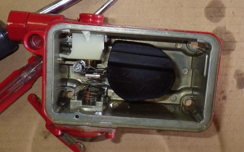

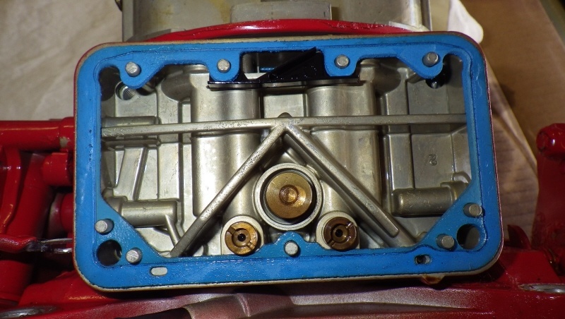

FWIW, I've used Stabil in ALL the gas in my 2008 boat with a Holley 2300 carb purchased in 2007 new. ALL the gas has been ethanol polluted going through this carb. Around here you winterize in October and it sits until March. You fill the tank 3/4+, add Stabil, and fire it up next year.
Recently I tuned it up (Lol, a whole 6 plugs) and for grins I pulled the Holley figuring I'd clean out all the scum and crud accrued in the last 8 years.
Look what I found......................
I was under the impression that marine gas didn't have ethanol....oh well.
