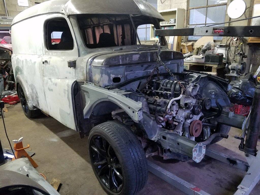

Ditto with my '50 Panel Van... It does have an '06 HEMI and NAG1 auto trans, but nothing is hooked up right now and nothing leaks:)

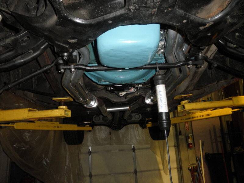

My '62 sat in the garage all winter without a drop. Then a few weeks ago I jack up the front, then the back with stands on all four corners. The car is setting level and the back of the pan starts leaking just a drop or two. This leak comes from not filling in the rear seal retainer bolt holes before putting on the pan gasket. That's taken care of now because I replaced the pan with a different one and filled the holes this time. The rear seal and side seals are dry.
Then the throttle shaft on the trans starts leaking. So I replaced the seal while I had the car up on stands. The seal was only two years old and I'm thinking that jacking the car up started a torque converter drain back that overfilled the trans and revealed the worn seal. So for the time being everything is dry under there!
