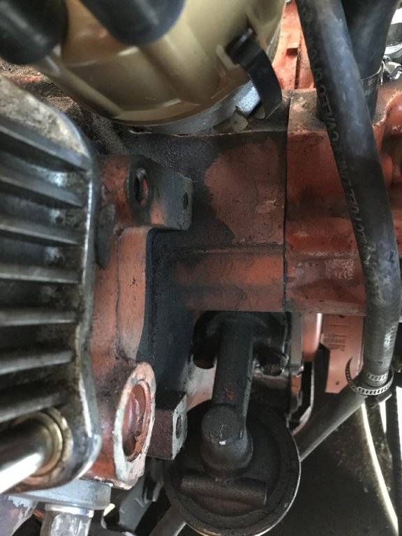

I just picked up this alternator from Napa. It’s what comes up for 1969 plymouth 383. I’m not sure my motor is 69 though. It doesn’t look the same as the alternator I pulled off. I pulled two wires off my old alternator, I’m assuming this one would wire up the same.
If you look on the ID pad by the dosteibutor it should say for example - D383 that’s tell you the year

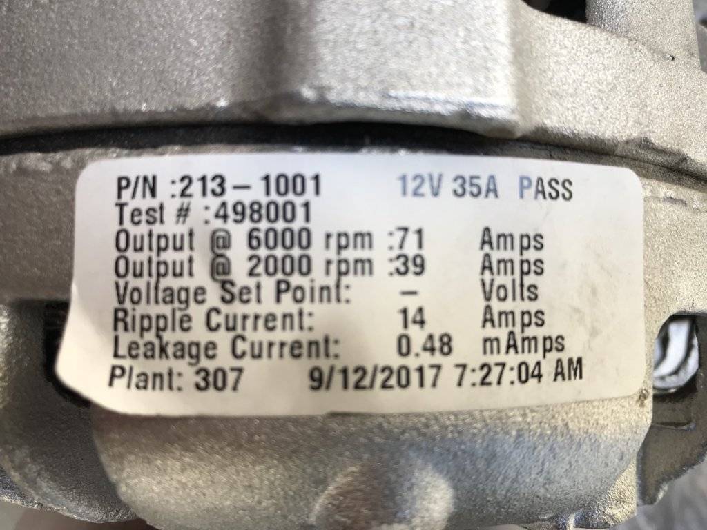

So it is a 1969 Motor. Does it matter that I use this style alternator. This is the alternator that comes up for a 1969 Plymouth with 383 but it doesn’t math the alt I took off. Here is a picture of the output numbers.
That should work fine as far as I know, maybe someone with more knowledge about alts will chime in

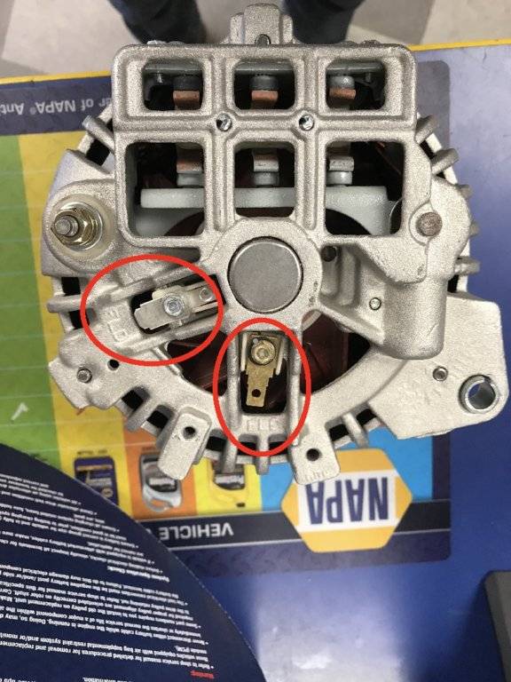

I'm getting old but it looks like it'll work as is. I don't see a 2nd field connection, it'll work just like ur original(dim hdlights @ idle) not much charging at an idle.
I circled both fields in red.
On 69 and older cars you ground one and hook the green field wire to the other.Good to go unless you are looking to be period correct. The Square Back alternator is a newer style (and higher amps) that was not used in 69.70 up uses the 2 field wires and the one goes to ground in the Voltage Regulator. Not sure when the Square Backs came in to play.
Ok it is your lucky day! You got aN allmost DOUBLE efficient alt than the one original from your car. It is couple of milimeters wider than the original one.
That's a laters 70s and 80s alt not the first squareback series alt which looks on a side view the same than your original one. Your car will be HAPPIER with that alt.
It seems the brush for the field is already modified, getting cut the prong and mostly sure the isolation washer being replaced by a metallic one to be grounded. Prong was cut intentionally to not conect the field there causing a short. The earlier setups ( mech regs ) are regulated by positive, opposite to the post 70 alts ( 70/71 roundbacks included ) which get both brushes isolated being regulated by negative.

Okay. I thought the numbers would’ve been higher on this. Here is the link to the voltage regulator I bought. It’s the same one I had in the car before.

of course there is BETTER alts able to give more than 45-48 amps at 2000 rpms ( that is about 42-45 engine iddling ) which is way better, but you got that one without think on an upgrade, on same price rate than a "correct" 69 roundback alt. Correct 69 roundback alt is able to put around 45-50 amps as max output, being half at iddle. Your car will be gratefull with those 10-15 amps more idddling
