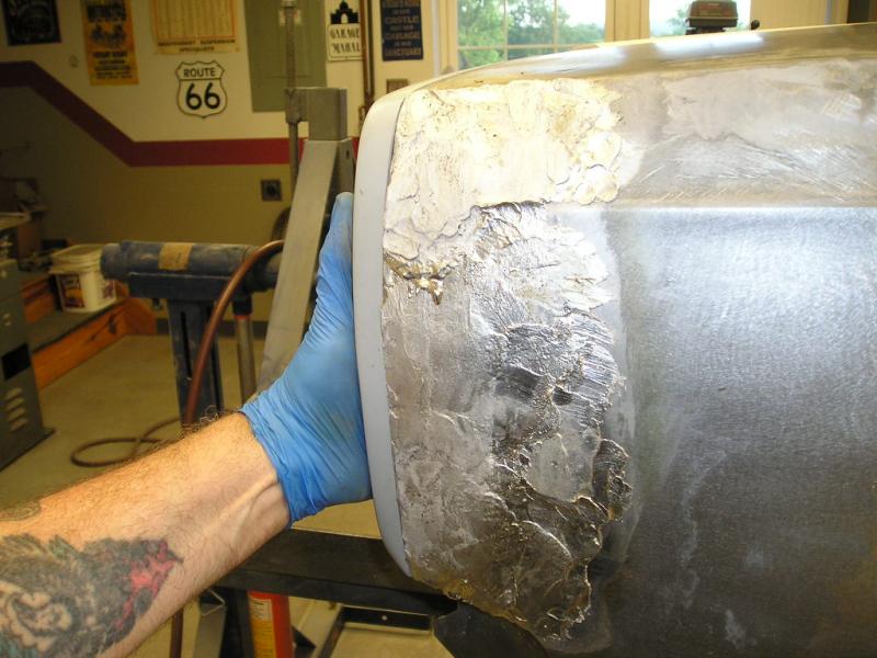

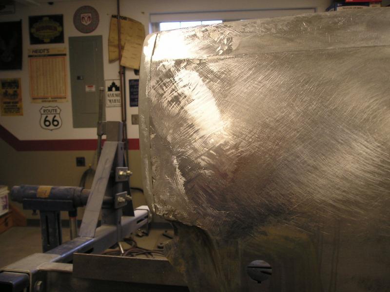

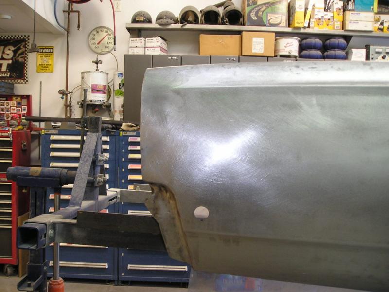

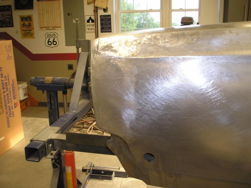

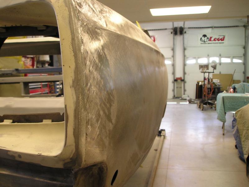

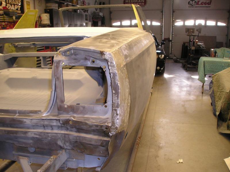

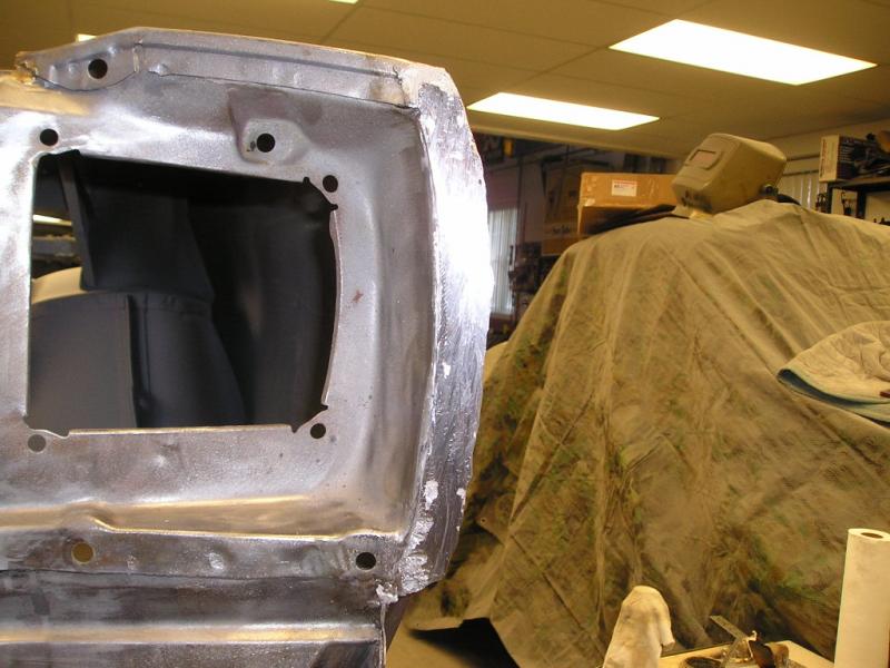

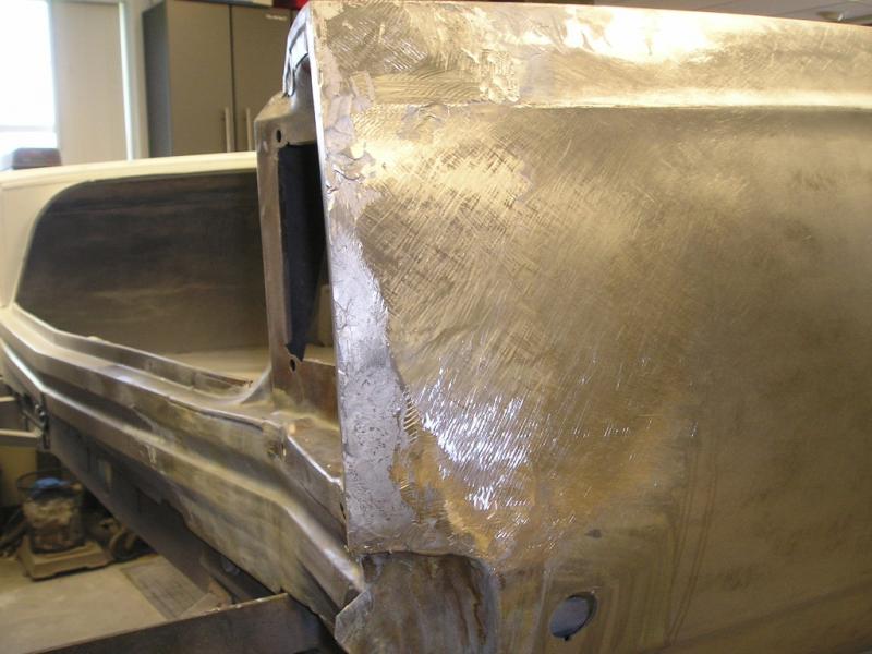

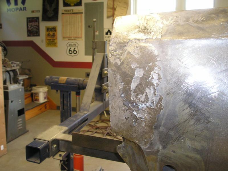

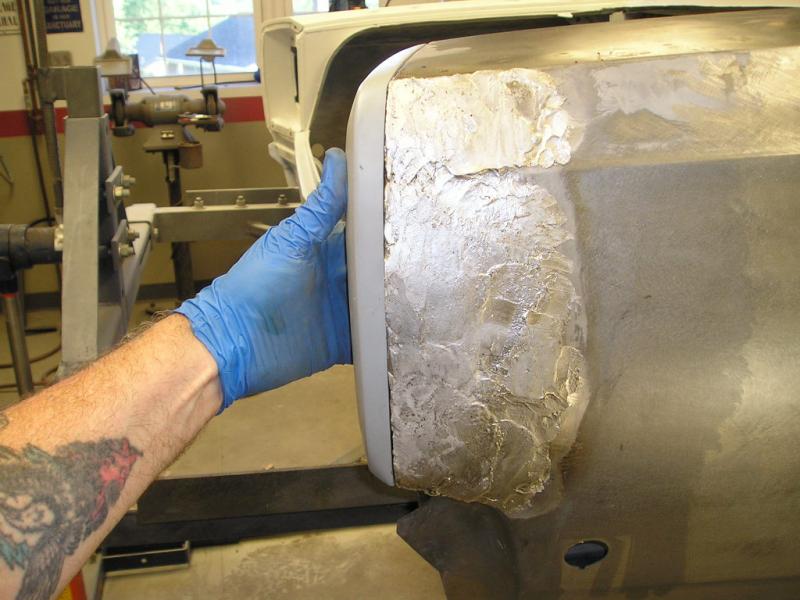

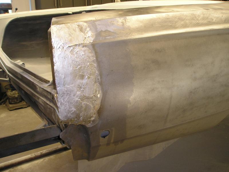

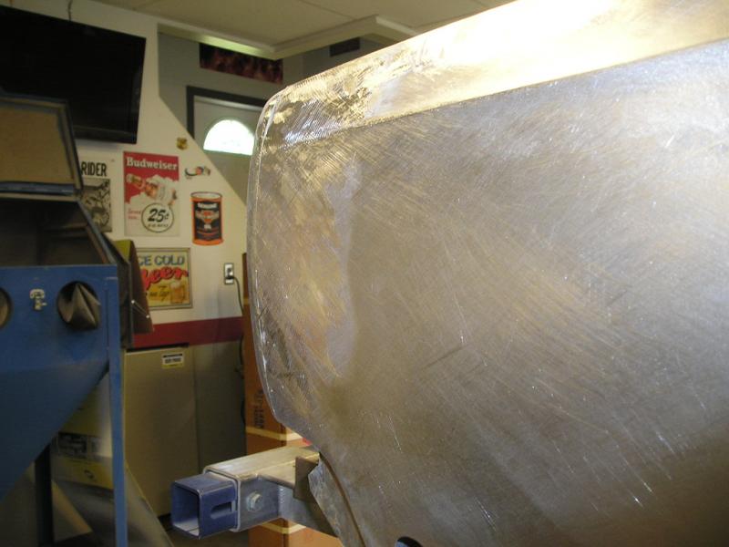

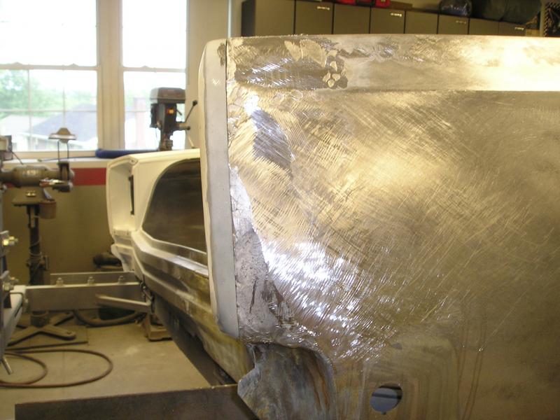

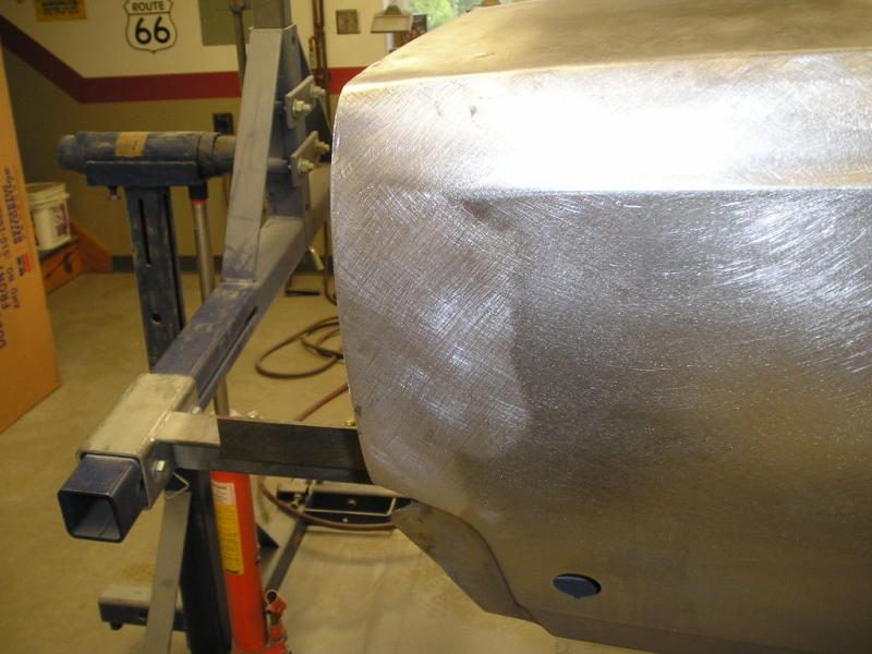

I don't know about you guys (and gals) but one of my pet peeves is how the quarter extensions line up on a '68 B body. The either don't fit well on the top, on the side or both. You're stuck with finding a happy medium which usually sucks too.
But alas, there is hope. Get out the torch and have a go at slinging some lead.
P1010021.jpgP1010022.jpgP1010023.jpgP1010024.jpgP1010025.jpgP1010026.jpgP1010027.jpgP1010028.jpgP1010029.jpgP1010030.jpgP1010031.jpgP1010032.jpgP1010033.jpgP1010035.jpg

That's some fine looking lead work there. Is that real lead or the lead free stuff and how easy was it to work with? From the videos that I've been watching on Youtube it doesn't look all that hard.

That is nothing less then impressive there, ive read about using lead and seen some guys work but you seem to have taken it to another level which looks as nice as any "bondo job" ive ever seen! I wish you good luck with the rest of your build but i don't think you need it seeing this. Very nice. I didn't know the 68 had this problem and im to far away to wonder if 69 is the same, but i will be looking in on your work after seeing how intensive your being getting things the way they should be. Thanks for posting...

Hat's off to you mate! I have seen plenty of attempts on lead wiping, but your finished result is awesome! Have you done this before?

I use real lead and no, it's not terribly difficult. As you can imagine, working on a verticle surface is much more, uh, challengingthan a hrizontal surface, mainly because the solder has a very narrow plastic state.
That is to say it goes from solid to liquid real fast if you're not paying attention to your heat and all of previous your work ends up on your toes.

Lead work is very much like welding in the regard that practice goes a long way in improving your skills.
Tools matter as well. If you're a novice and try to learn with an o/a set up, you're most likely going to have a rough time keeping your heat consistant. Not that it can't be done mind you, it's just harder because the flame is not "soft" enough.
If your going to do lead work stay away from lead free. It takes too much temperature to melt and is very hard to file. Wear gloves get the metal shiny clean, apply Acid flux, file with transmission fluid to keep fiole clean. Gloves respirator and finally hand sand. Nothing compares. it is water proof and is flexible to the steel. 80/20 or 75/ 30 with map or propane torch. Neutralize with baking soda and also crisco or lard for the paddle to keep paddle from sticking and burning.
If your going to do lead work stay away from lead free. It takes too much temprature to metl and is very hard to file. Wear gloves get the metal shiny clean, apply Acid flux, file with transmission fluid to keep fiole clean. Gloves respirtator and finally hand sand. Nothing compares. it is water proof and is flexable to the steel. 80/20 or 75/ 30 with map or propane torch. Neutralize with baking soda and also crisco or lard for the paddle to keep paddle from sticking and burning.
This is extremely important if you wish your paint to stay on the car for any length of time.

Cool thread Pete. Thanks for posting. Can we refer the '68 as "the Lead Sled" now? Hehehehe. Great info on here from all. Makes a guy want to go melt some stuff.
