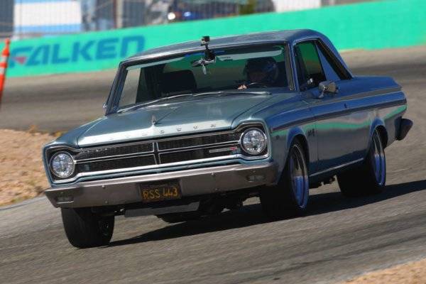

Just love this pic with the fatties....

Looks awesome. How's the new suspension working out? Better times?
The 65 Belvedere is one of the best looking cars ever built, in my opinion. Great picture, you should use that as your Christmas card.
I went out in October but I was having those issues with the loose ball joints, thanks to the crappy installation. So I didn't even complete two sessions, and called it a day. I got home and found all four ball joints were never tightened, and one was backed out a ways. I did knock a couple seconds off, but my hope was to get a feel for the new suspension and lower the car a little and play with the adjustable settings. I'll have to do that in March when I go back out there. Hopefully my health will be fine by then and my doc will clear me to race.
:thumbsup:RoadRacer, nice hearing the updates on your car and best wishes until March!
Wow I love how flat she corners too
looks mean low & full of meats
gotta' love the suspension & rim/tires upgrades too
