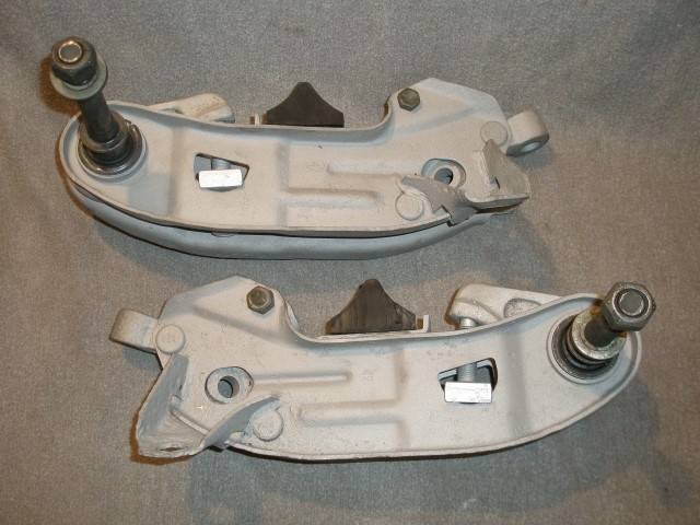

Ok... this has being really confusing... How can I tell the difference between these LCA ? Of course I'm talking about 66-72 B body LCAs and all A bodies.
Are they REALLY different ? I have seen two kinds VISUALLY diff ( not measuring ) and is just about the Shock Absorver support
I don't know If I have seen maybe 2 or 3 models with this area diff.
Maybe a year difference ? or model difference ? or both ?
There are many differences A,B,C,E,F body and if it has a factory swaybar or not... as with the upper arms and spindles... and year to year differences some are interchangeable some can be mis matched to gain caster and camber gains... I am not sure of the differences and the combos that will get you the preferred set up for each I just know there is differences.... someone on here does know and it comes from the protouring guys looking for max cornering my self I have not experimented with it
A body LCA is actually longer than B body.
Geometry nightmare?
REALLY? A BODIES ARE LONGER ? I was thought backwards!
note these for example ( despite the conditions ):
which one is for what body?
note the diff on shock absorver attaching point
Now... if 71 and laters B bodies are wider ( like E bodies )than earliers... what about the Control Arms ?
Rear axles are wider in fact!!!
guys this is a nightmare!!!
B body K Frame is wider.

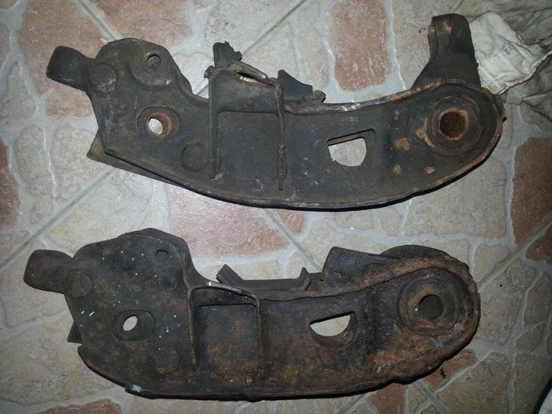

you can see some noticeable differences on the pic I posted.
ok, here is what it comes about my info search:
I have found these:
per seller description, this is a pre 70 B body LCA
index.php
if you notice the shock absorver bolt location, seems to match the top LCA location on first pic posted
then we get PER SELLER ( once again ) description, an earlier A body LCA:
if you compare once again the shock absorver bolt location ( and shape ) seems to meet the bottom LCA from the firts pic.
BUT, on first pic bottom seems to be shorter than top one!!! optical ilusion ?
and thats what I have found about LCA itself differences at least and is not clear yet... can't talk about Pivot differences yet as mentioned here.
Top set are 68/69 B body with sway bar. I never saw any like the bottums before on Any B,body?
Just an FYI for those still concerned: The A body LCAs are flat across the bottom, the B body versions are curved.
They say right on them what they are for. There is a stamping. Or just look at them as FrankenDuster says, flat or curved.
