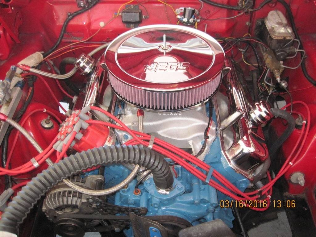

So this weekend I was getting the car ready to go to the track I felt the brake pedal bypass when I came to the end of the street. So I turned around and went back. So long story short I replaced the master and line from the meter valve to the master. And I have had a Jegs line lock solonoid and tried to install it but fitting issues changed my plans. I'm still looking for what I need but I'm not sure how or where is OK to mount. Thanks for your help in advance K
