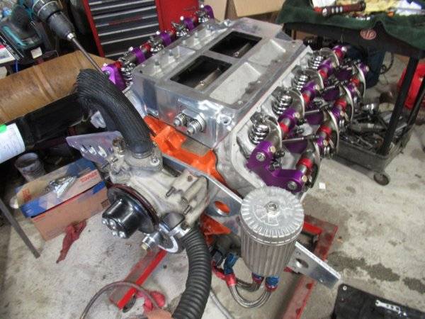

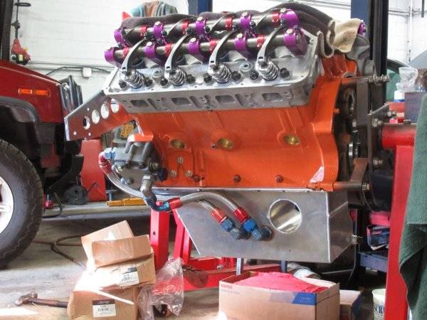

I ran mine with a Hughes Whiplash Cam. Spring pressures weren't insane, and that was purely for a street application. Ran 13.00's at the track. I know setting them up correctly plays a huge factor in longevity. I sold them when I went to a solid mechanical cam. Now I run Harland Sharps.
