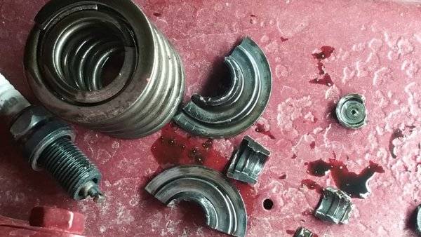

I'm going to need a set of retainers and I don't want to go through this again. Can titanium retainers work on the street and is there a life expectancy on a steel retainer or any type retainer for that matter? These were 10 degree heavy duty supposedly. I bought the heads from RHS which turned out to be indy years ago and I only know that because I bought the open chamber heads for my step head pistons and received the closed chamber heads and had to ship them back. I have 13,000 miles on the engine and just want to know what type of retainer will go more than 20,000 miles with a 587 lift cam. Am I dreaming? Rant over, thanks for any input on brands or part #' that will help. 11/32 stems with single groove valve tips. Thanks in advance for any help you can give. Ken

That looks like a Comp Cams tool steel retainer. It is an excellent retainer. A 10 degree retainer might not be necessary for a cam less than .600" lift, but still should work. If it is a tool steel retainer, the failure may be just bad luck, or some of the potential problems that others are pointing out.
