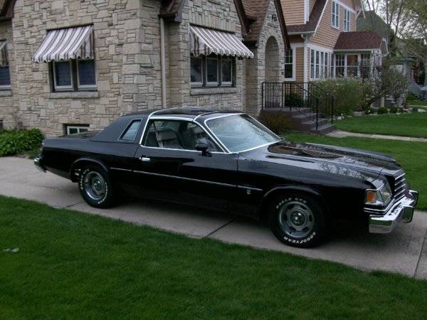

the encased metal was not rust proofed and thus rusted. Rumor is to cut thru the back, removed the rusted metal and us two sided tape to hold the floppy flare onto the car. Mine are perfect except RF one just starting to pull away.
Thanks for the information Pete. Hopefully someone else will respond that has tried this, or has any other ideas. I'd just like to know for sure what I'm getting into before pulling the trigger on a purchase. Gorgeous car BTW Pete!
