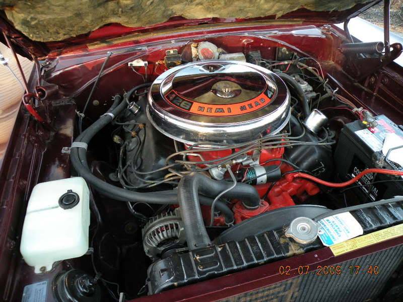

carter gm4862 mecanical fuel pump. i used it on my 528 hemi belvedere, more than enough pressure 8-9.5
Thanks Superstockracer! What size fuel line are you running with the Hemi?
