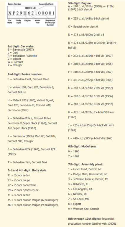

Plymouthman72: Thanks for making me feel better! I too prefer the console and buckets, but don't want to give this guy "all original" dollars for a car that's NOT an all original car!

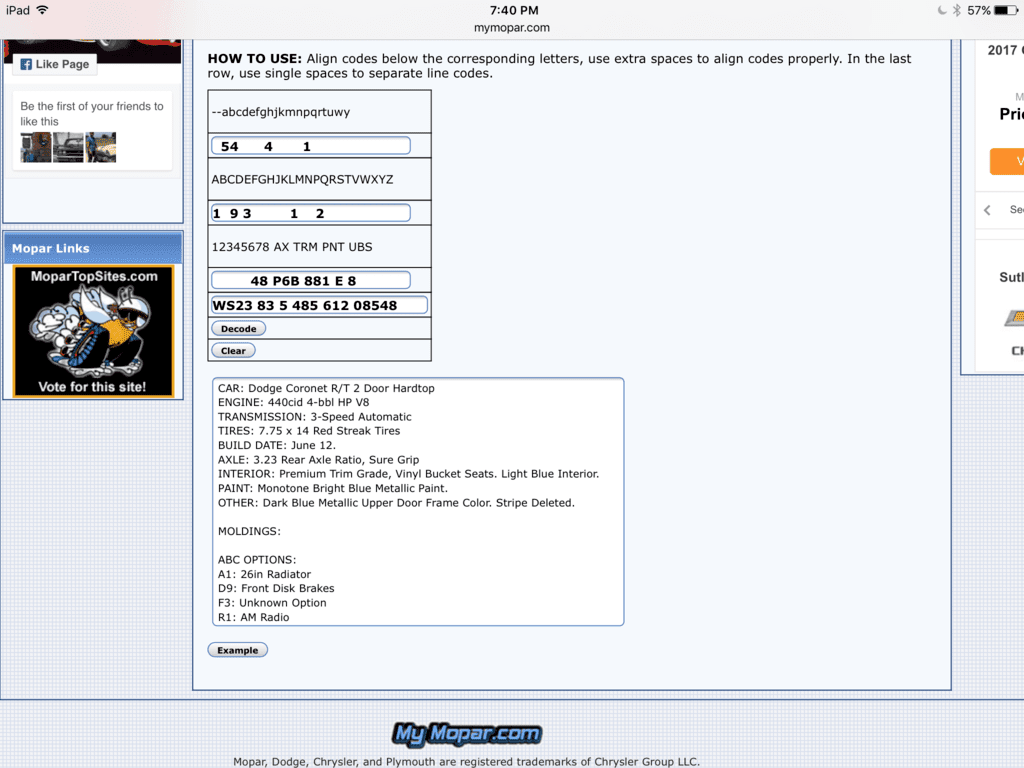

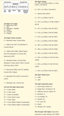

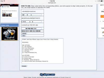

Fwiw...there are mistakes in the VIN decode attachment......

Thanks, 69Coronetrt. Can you post a correct VIN decoder chart for me? It would be greatly appreciated. - Bill

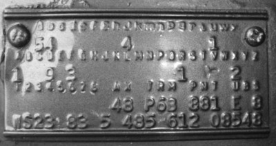

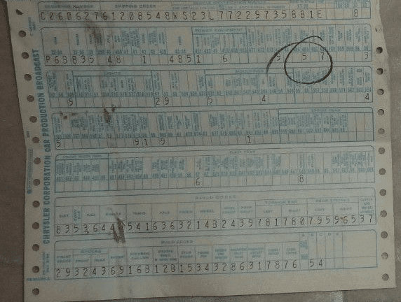

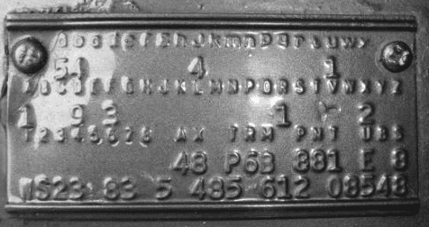

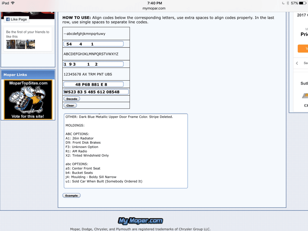

69Coronetrt & Metaldad, I don't have a pic from the VIN tag, but here's the fender tag and broadcast sheet. Hopefully, these will help...???
Screen Shot 2017-09-26 at 6.11.13 PM.png Screen Shot 2017-09-26 at 6.09.40 PM.png

The top row '54' is where the codes are for console and seats. Go to myMopar.com and you can decode the entire tag. Build sheet looks mint. Sounds like it has some issues for a car that was restored, kinda odd.

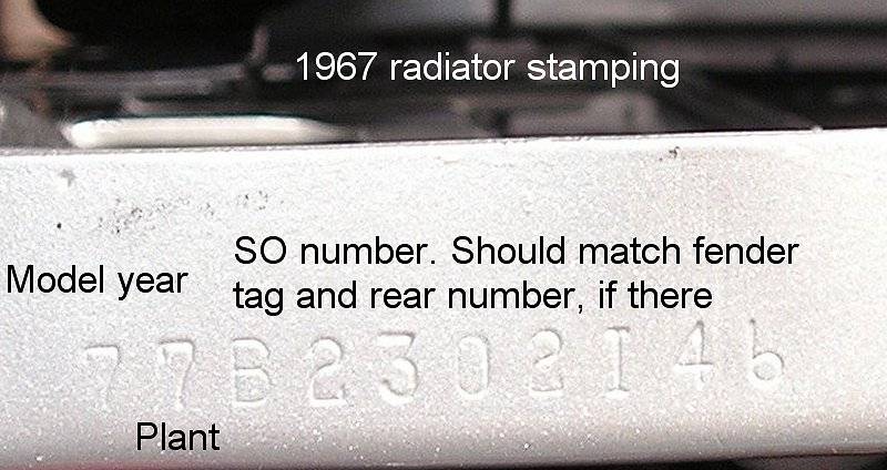

They look great. Now, just match the body to the tag and BS. Look for numbers similar to this picture on the radiator support but with your numbers: 7761208548

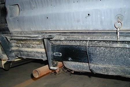

Some cars have the numbers stamped behind the rear bumper:

The PDB and PS are nice. I can't really read or enlarge the BS to see what other options, not coded on the tag, came with the car.
