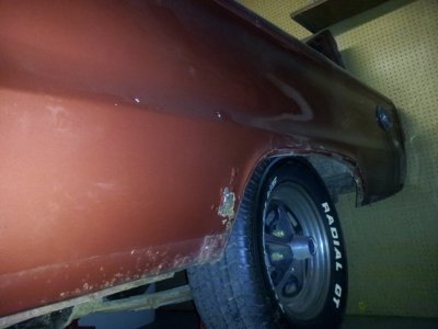

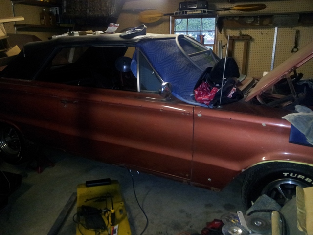

Best shot of the car that I've got now

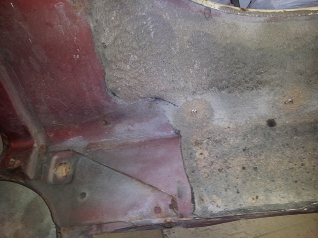

Here's the bad part of the body that'll need to be replaced

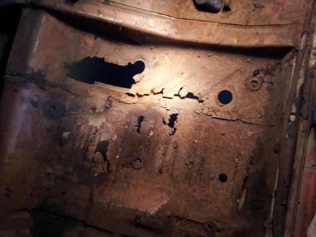

Passenger Floor pan ( or lack there of )
Driver's Floor pan ( or lack there of )

Rust looks pretty typical but the car looks pretty clean over all. Should be a pretty easy fix. For inexpensive floor pan patches you can go to Rockauto.com and buy the sherman panels, they work pretty good and are much cheaper then others.
Love that copper color.
If you go with the full length quarter patch panels, you are probably going to need trunk extensions and outer wheel housings as well. I did the long floor pans, but you may need front and back both as your floor rust goes pretty far back. The outer wheel housings are pretty much unobtainium. Most off another car are going to be rusty also, and anyone who has some that are decent is not usually willing to split inner and outer and wants to sell the whole thing in one piece. Plan to do some fabrication there.

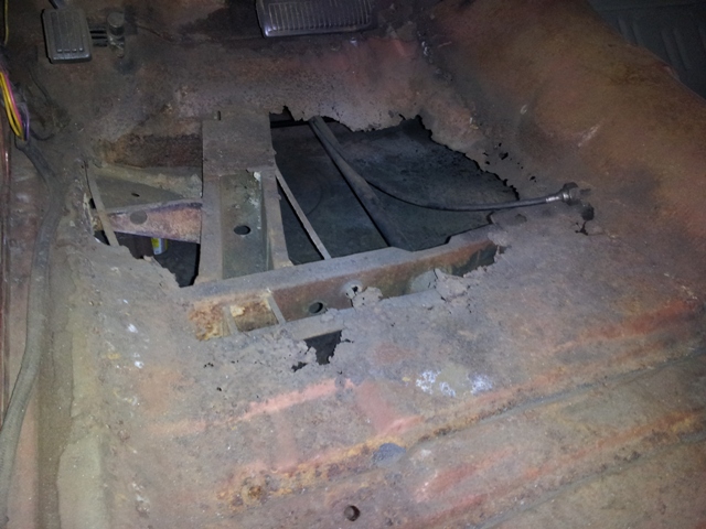

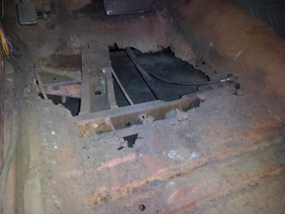

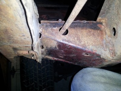

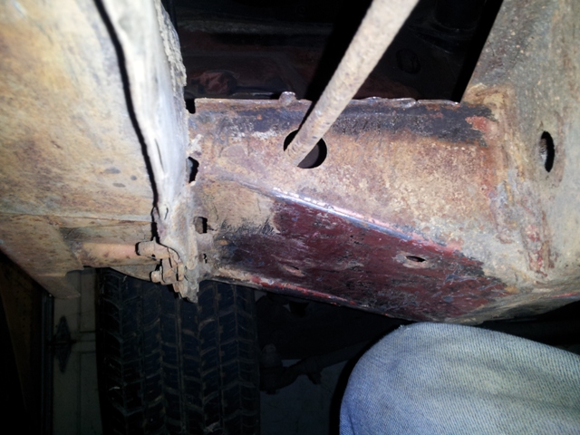

Interesting parking brake cable routing
Working on the car and find out that I'm having a hard time fitting the floors into the car and getting them to lay down flat. So I crawl under the car and find the following situation with the parking brake routing for the cable.
So since there was this very nice, and convenient, hole in the vicinity, I took advantage of it . . . and it helped with the cable angles too.

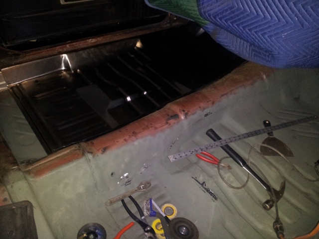

As I've said, I've got some more work done, but I've had a busy time trying to get caught up around the house, so the pictures are way behind on the actual progress of my build. Here's an update of the floor replacement . . .

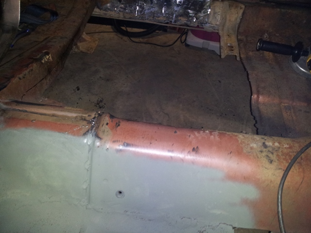

Removal of the rear seat driver side

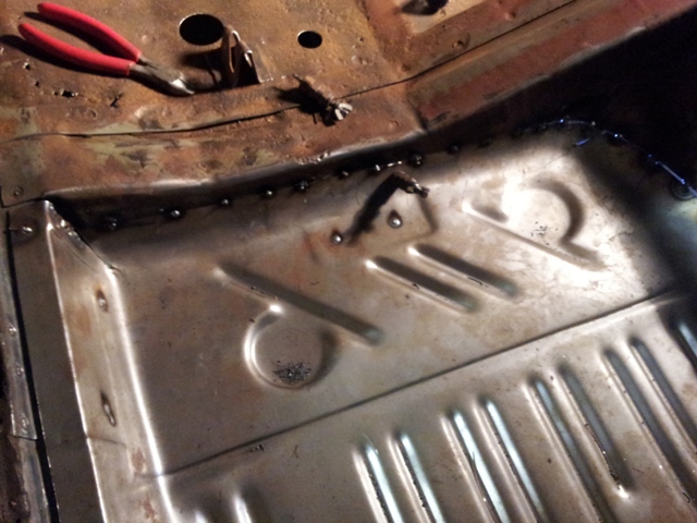

Driver side rear seat being removed
Passenger Rear seat tacked in place
Bottom of completed rear seat welded in place
Little rough on the welding, and I'll clean up the welds more later . . . but my skills are getting better with the more practice I get welding the panels in.

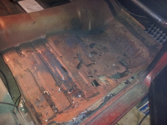

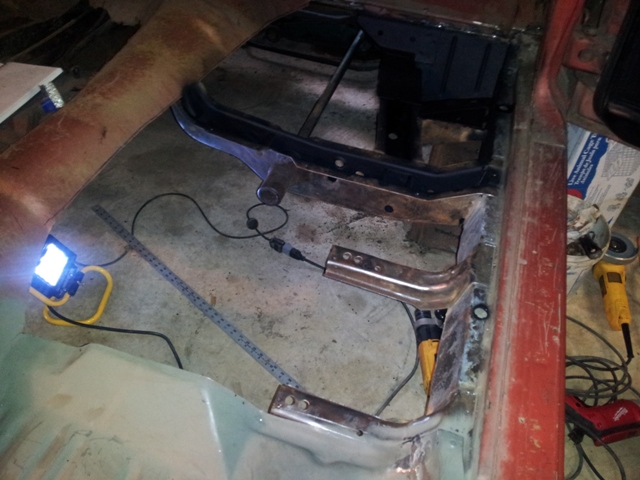

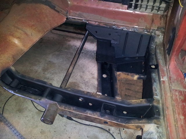

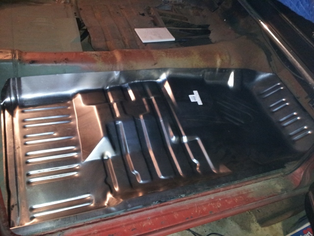

Trying to update everyone on the progress of the floor pans in my convertible.
Reminder of what I had to start with

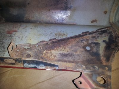

Passenger side removed - frame rails cleaned and primed
Another closer look at the frame rails

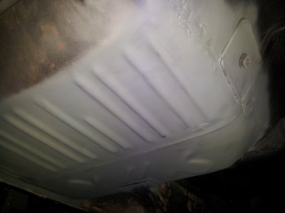

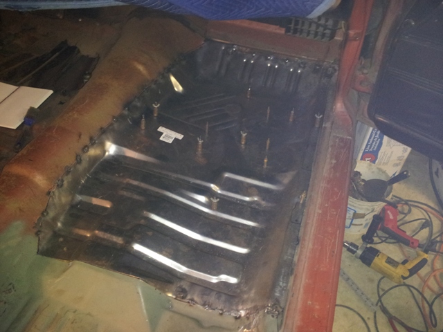

Test fitting - dropped in the original floor plan to start trimming it to size
After a bunch of times in and out of the car to fit it, it's finally tacked into place . . .
Here's the final product - the passenger side is completed - little more grinding and fine tuning yet to do
I think it's coming along quite nicely . . .

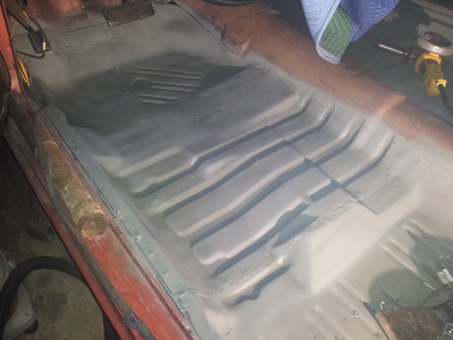

Once again - here's what I had to start with on the driver side - uh, should I say didn't have to start with ( I'm coming Fred Flintstone )

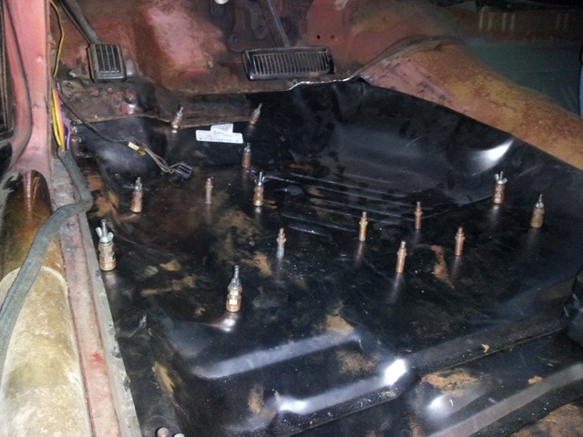

Full panel set in place to start the fitting process . . .
Getting the floor pan to sit down right and fit into place - very happy with how this one went in . . .

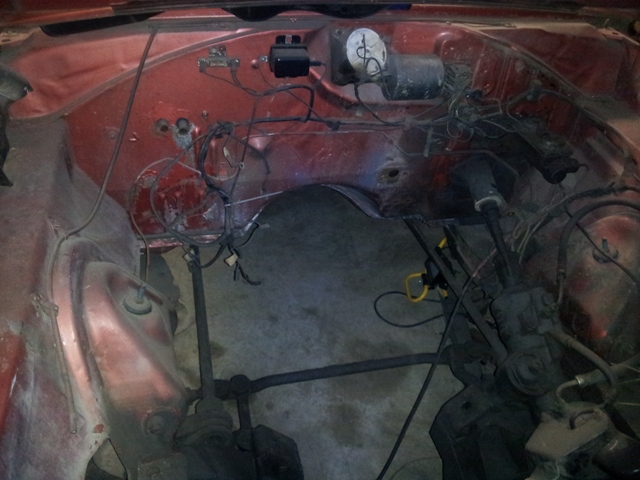

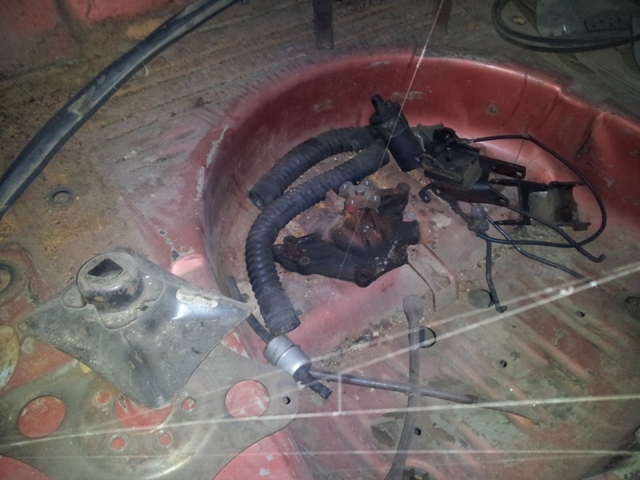

Have not posted a pic of the engine compartment nor trunk yet . . . so I'll get them out here now
Engine compartment ( duh )
The trunk in this car is in really good shape

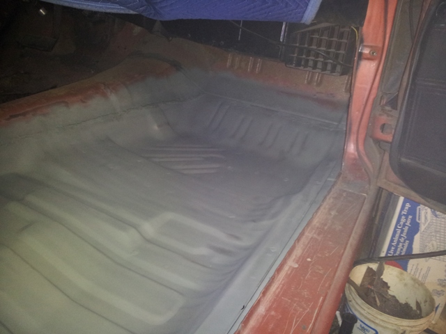

Got the driver side in primer to protect it from rust . . . turned out pretty good . . . will revisit it later.

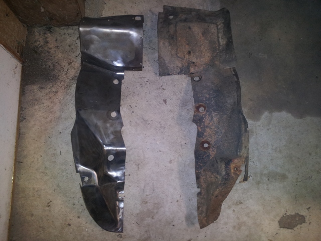

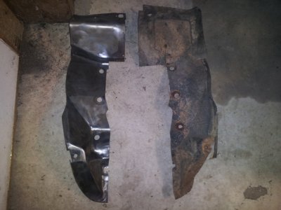

Lo and behold the work that I found when I got out to the shop . . .

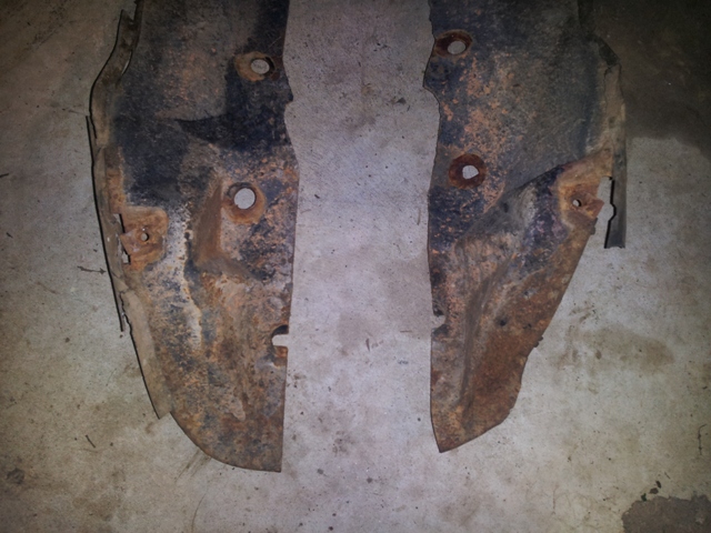

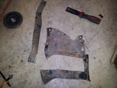

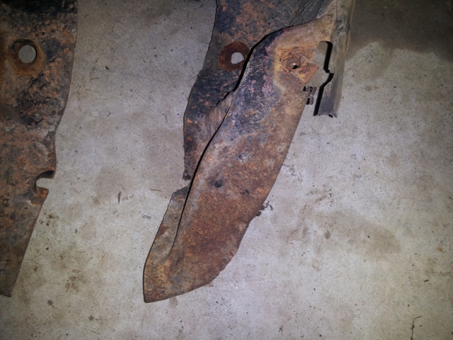

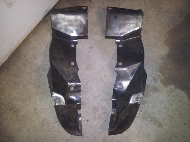

Here's the lower front quarter panels inner panel ( did I say that right ? ) - they look pretty rough
This one had an encounter with a not so favorable opponent - and lost . . . . bit dented in
Progress on the cleaning up process - not looking so bad after all
Even was able to get the dent pulled out of the bad one ( still needs a bit more work ) but it's going to work just fine.
Still got a little crease in the metal that I'd like to get moved where it should be.
Work continues . . .
Those look like the inner splash shields. If there is supposed to be a rubber seal on the edge of them, you can take an old door jam seal from a dodge pickup and cut it to size. Make sure it has the groove that fits over the lip with the rubber seal. That what I did with mine. The rubber sits right up against the inside of the fender.
Thanks roadrunnerman . . . still working on the names of all these parts. Still got the rubber seals, but they're pretty much toast. Will be looking into your recommendation and any other leads I can find for locating the replacement rubber seals. The back sides have a little surface rust, so I'm going to run them in the media blasting cabinet before primer - then maybe bed-liner to have them last.

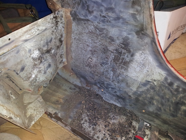

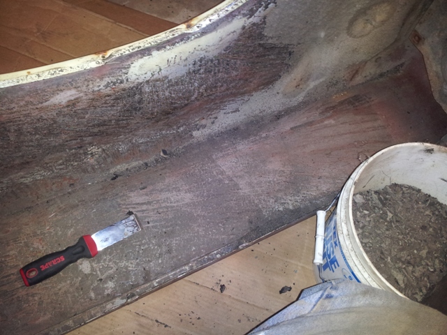

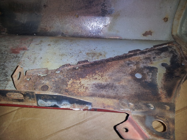

Took the fenders off this past weekend and spent a little time removing the ugh-der coating ( not too fun ) but this side, the drivers side it ready to take the wire brush to and do the final cleaning

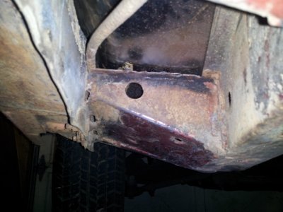

Got a little bit of cancer on this fender support - but I've got the passenger side to use an example to get it fixed up
Now on to the passenger side . . . and wow, this thing weight 50 pounds, I think I've hit the mother load of ugh-der coating on this fender . . . my work is cut out for me on this one

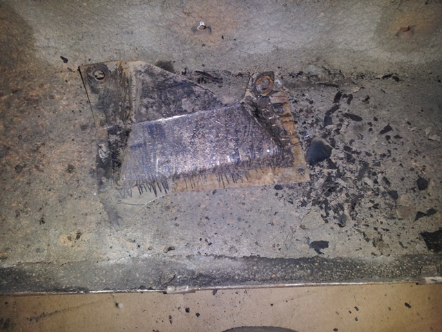

Pulled out the front splash guard and the rubber seals, but there toast too - hard as a rock
5 minutes later on, the gunk is removed and ready for the wire brush and media blasting cabinet

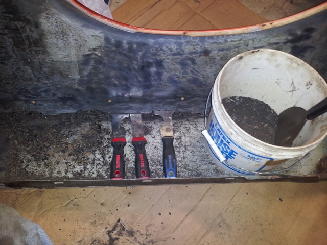

Now onto tackling the removal of all this gunk from inside the fenders . . . notice my collection bucket as I fill it up with the remnants. By the way, this is the second bucket full of stuff removed from my car and collected already . . . you can also see my tools of destruction, your typical painting scrapers seem to have the best luck for me so far ( I don't have a needler ).
So, an hour later and I've got a good portion of the inside of this fender cleaning up nicely. This stuff was caked on there over 1/4 thick, maybe even 3/8 thick in spots . . . gonna be filling my bucket up pretty fast with this one . . . yup, it's filling up alright.
