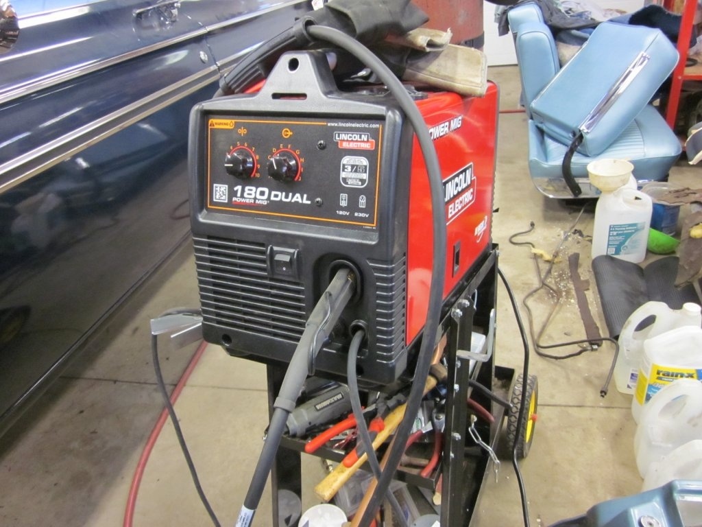

My first mig welder was a Millermatic 140. Really struggled with the soft start feature when welding sheetmetal, and it cant be turned off. Otherwise it was ok. Traded it in for a Lincoln 180 dual and never looked back. One of the best purchases I have ever made. The Lincoln is a great machine.

Lincoln dual works on both 110 & 240V. Been a great machine for me. A 20 amp line may not be enough at 110V. it'll be fine for thin sheet metal work but the heavier frame metal might require more current. Just check the electrical requirements against what power you have available.
