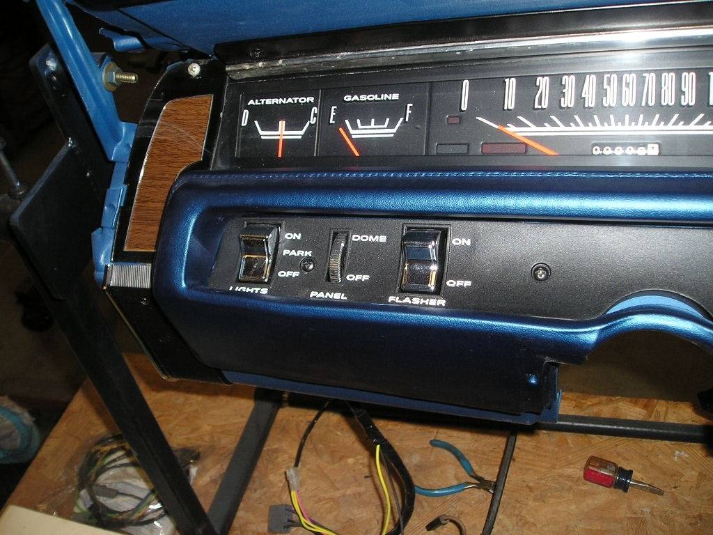

Hey guys. The letting on my dash (lights, flashers...etc...) has worn off & I want to touch it up. I'm assuming the best option is to use a paint pen with a chisel tip but wanted to see if anyone had a better idea.

Took care of fixing this today as well. Used a pencil eraser which worked ok, with White Testors paint. I dabbed the eraser into the paint then blotted off the excess on a wooden block. Overall I'm 75% satisfied with it, it's definitely an improvement over what it looked like before. Had to used a fine pointed scraper to remove some of the excess paint that sometimes filled it some of the letters. I did a few of these 2x as I was not satisfied by removing the paint with a soft brass brush.

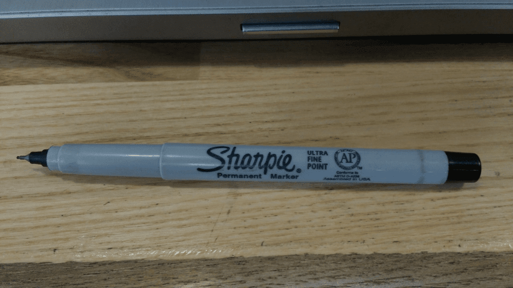

A good craft store will have a very, very fine tip marker in black which you can use to color in the spaces that inadvertently got white paint in them. This cleans it up a bit without having to strip the dash and start all over.
