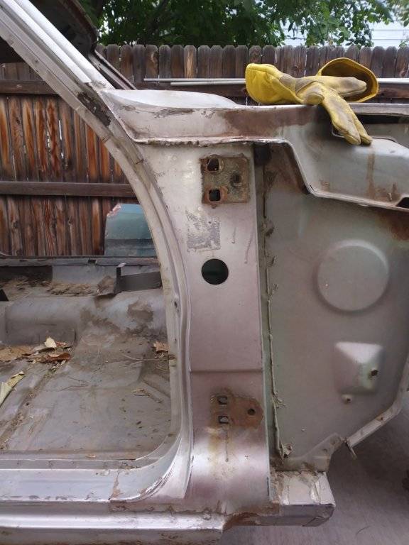

Hello,
Here is my problem i need pictures of a 66 power window wire run between the door and body
Also is it being repop ?
Thanks

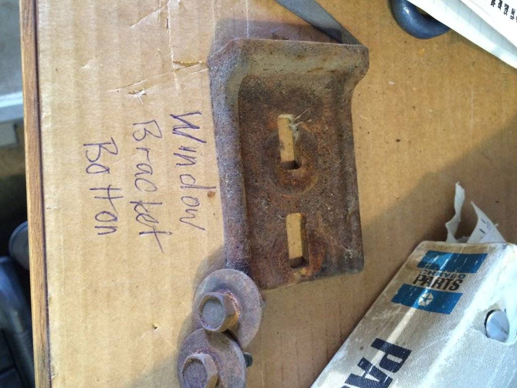

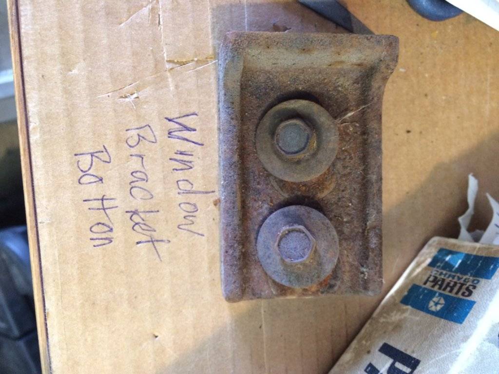

I'm curious if your power rear windows have the stop manual cars seem to be missing.
Great point! I just finished assembling my 67 non-pwr car and I had ONE downstop. I could not find the other and 4-5 parts cars didn't have one, which seems odd. I attached a picture, if you see them at the bottom of your rear windows, please tac a pic or at least post about it. Thanks!

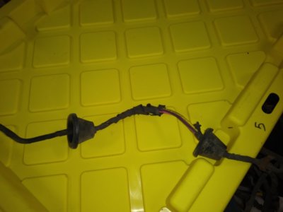

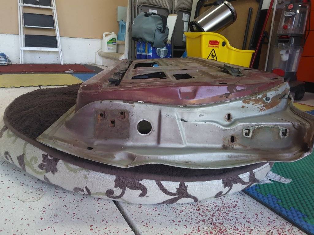

Update.
dug out the old harness formy power window a/c car, window wires run thru grommets and only wrapped in cloth tape
I'm really late to this party but wanted to point out that one of those grommets is slightly smaller than the other so it can be fished from the car to the door. The door grommet is smaller.
