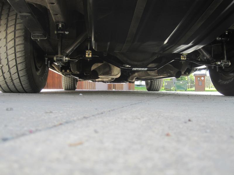

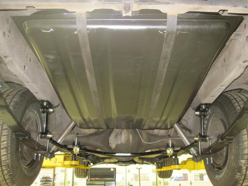

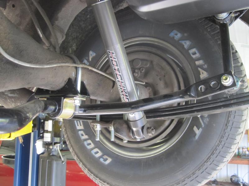

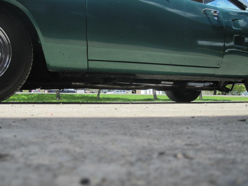

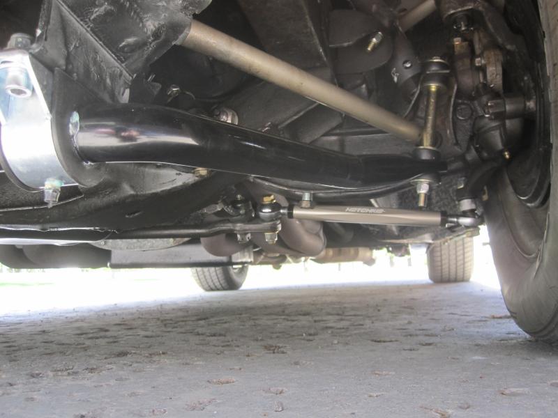

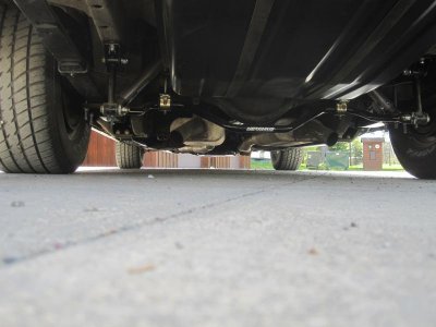

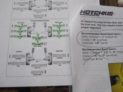

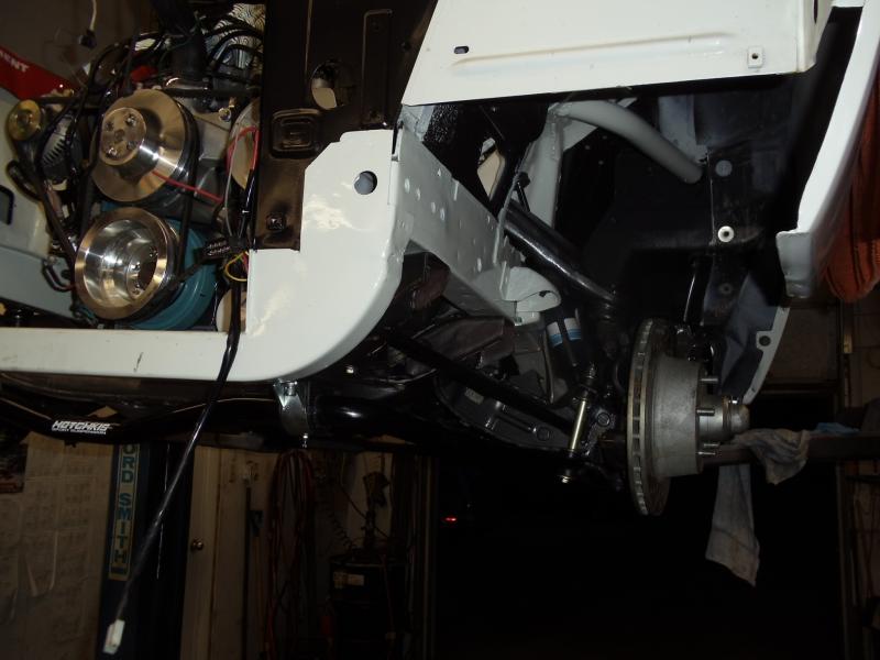

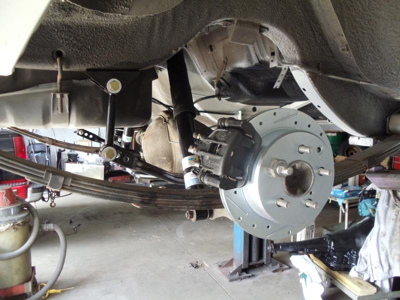

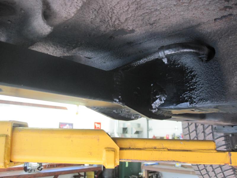

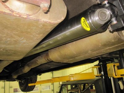

IMG_1766.jpg It took me almost 2 months of working Saturdays to finish up this install. It would go a lot quicker the second time. I got a case of the "might as wells" while involved with this. (might as well change the oil pan, tranny pan, gas tank, drive shaft, steering box, steering coupler, shocks, ball joints, brakes and a torque arm.)IMG_1799.jpgIMG_1801.jpgIMG_1802.jpgIMG_1805.jpgIMG_1804.jpgIMG_1797.jpgIMG_1790.jpgIMG_1795.jpgIMG_1785.jpgIMG_1793.jpgIMG_1782.jpgIMG_1769.jpgIMG_1768.jpg A real fun project,but you have to allow time to do it. The car drives great and corners flat. After I pay off my credit card from this, I may get 17 inch magnums. Thanx for checking out my post. Jack.

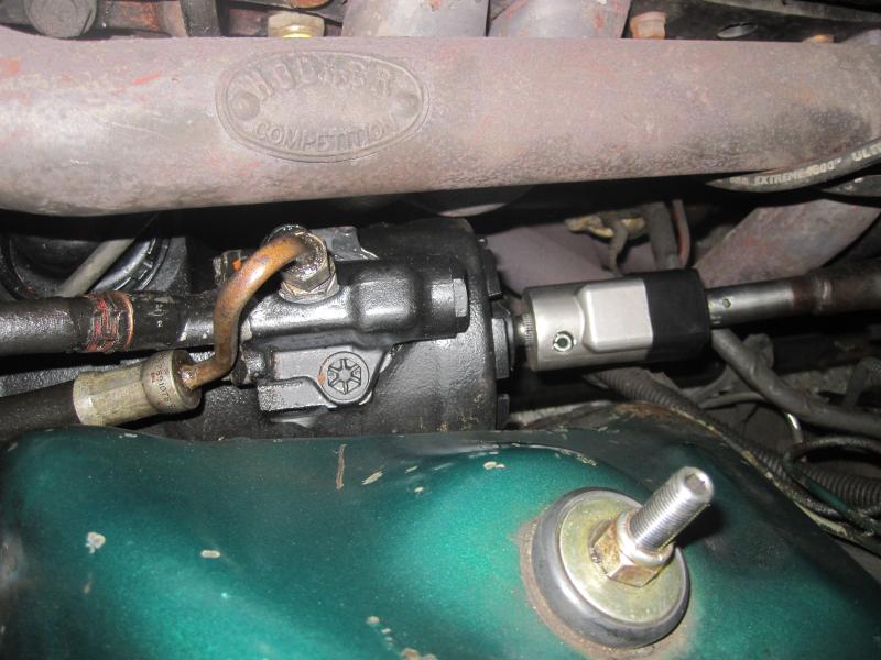

I really appreciate your post whiteknuckler! Did you go with a FF steering sector? If so what level.
I have only put about 200 miles on it since I finished it, but I cannot stop smiling while driving, it is so much different. Yes it is much firmer but very acceptable. I love the lower stance and I did have some chatter the first day,but figured out I had to put the shortest pinion snubber I had on there because of the lower stance, it was hitting the floor when I hit bumps.All better now. The new steering box is a firm feel from steer and gear in columbus ohio and that is a huge improvement also, everything is so nice and tight. I'm very glad I did this.

The frame connectors are the first I have ever done, but I have no complaints. The directions were spot on for everything they sent. The frame connectors even have access holes for the seat bolts. They are bolt on in the rear (4- 3/8 bolts that hold the front of the leaf spring mount) and weld on in the front. I got them all prepped and clamped in place and the weight on the suspension (4- 6 foot jack stands) and a friend of mine welded them and the front sway bar mounts on in about a half hour. I was a little worried about ground clearance, but everything is close to 6 inches.

I called and talked to steer and gear, told them it was a street-strip weekend car and went with their reccommendation. (firm feel is all he said I think)

curious is the sway bar from that year suppose to be mounted towards the rear of the car? I just have never seen that...

Nice looking suspension! Roughly how many hours do you think a professional shop would take to do it? (For example, half your first time time doing it). I'm looking at starting out with just the front/rear swaybar kits, for now.
Any other straight side-view photos of your car now? In that one pic, it looks like the rear is a tiny bit lower than the front, but probably just the angle of the shot. I'd like to see your stance on a level surface.
Ghosty the front & rear sway bars are easy peasy !! just an afternoon on you back, a little sweat equity & a few hundred $$$, as long as you have the skills & tools....
In a pro shop with good people, for complete suspension, it's a day job maybe 2 days at most with 2 guys that know what they're doing.... or 1 guy & a good helper
Yeah the sway bars I can do myself no problem, the ones on my Supra were cake. It's the complete suspension kit that looks daunting, definitely would leave that to a pro. Plus it would take me a week, lol.

Nice work. What size torsion bars did you go with - Hotchkis 1.03"?

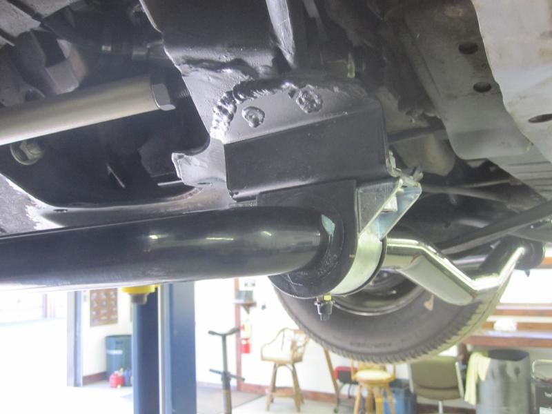

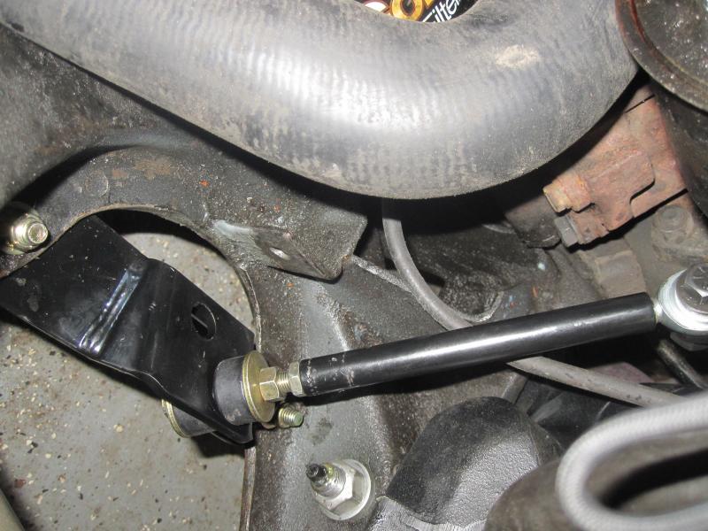

Your front sway bar is upside down. I also have a Hotchkis front sway bar on my '68 Satellite and at first installed it like that because that's the direction of the Hotchkis label. It's bent like that to clear the radiator support and if you flip it upside down from the way you have it now you will greatly increase your ground clearance.

Do you like the .97" torsion bars or do you wish you would have went with 1.00" or bigger? I'm trying to decide right now between .96" or 1.0" torsion bars....

Mine rides Great with the 9.7" T bars no complaints , But I will be moving to a heavier T bar when I get the rear Leafs done.

were the leafs 2 inch drops?
I was wondering how they would look on a Coronet. Was afraid they wouldnt drop me as low as I want to get.
