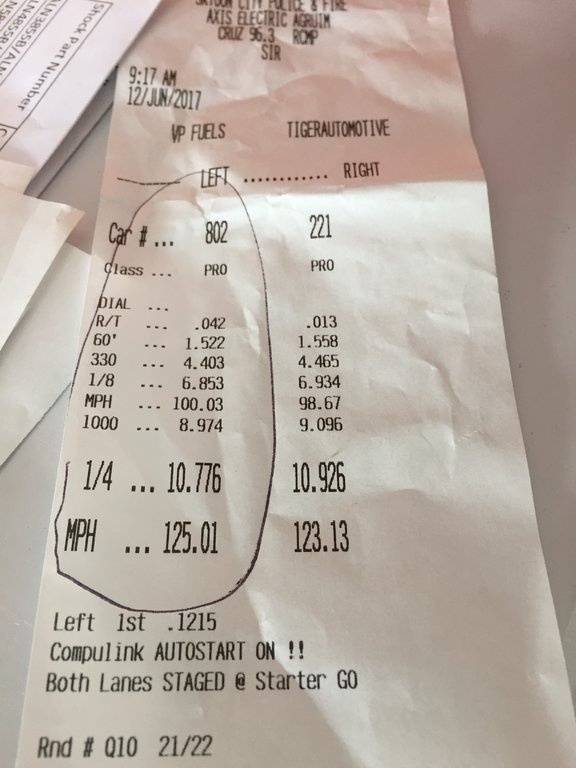

Mike, I've now made a half dozen passes with my Plymouth. My times are all over the place as I'm trying different things, not to mention only a half dozen passes under my belt. I'm running 4.10's with a 29.5" tire (ET Street 315R60) and I'm crossing the line at about 6300-6350 RPM if that helps.
Here's the time slip to compare.
Today I ordered a set of 29.5 X 11.5 slicks. With the ET Streets, as I turned up the launch RPMs the 60's would drop. I went with the same tire size as what I had and hoping that as I figure the car out and get some experience the car will gain a couple hundred more RPM at the end.
