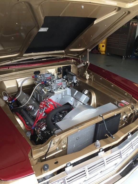

I have a friend who has a similar engine build as yours including the Indie two four barrel intake with Carter carburetors. It is in a 1965 Coronet. 512 cubic inches roller cam and big heads. He runs 10.1 - 10.2 ETs. I don't think you need to ditch those carburetors before you explore other avenues to get a better ET.

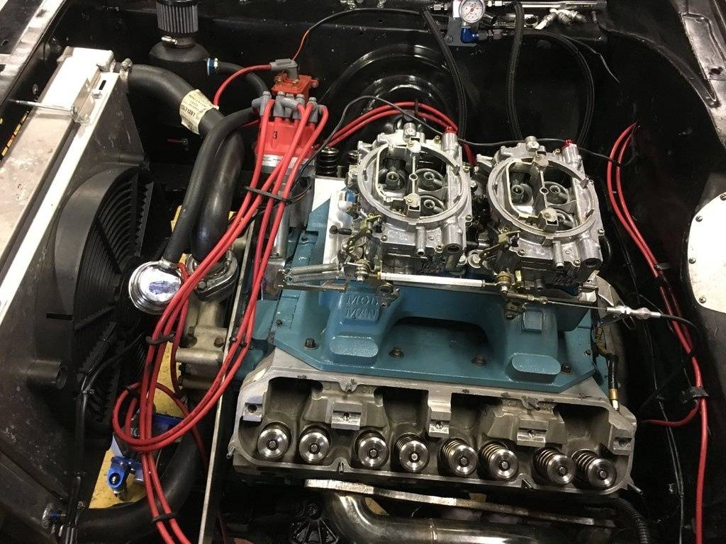

What modification to your Modman ? I have twin 600 eddies with the choke tower cut off .
I have 1 sitting on my bench , I fitted an insert to reduce plenum volume when running it on a 440ci motor . would like to try it on my 505 . Currently have a Victor and 4150 carb

The modman intake looks to have lots less plenum volume than the 440-25 intake that I'm running on my 505.
I talked to an engine builder who tested them back to back with the same pair of edelbrock carbs. He said the modman was down 12hp I believe to the 440-25. Thats all I needed to hear. I am not a fan of the 4 and 5 inch scoops on these body style cars. The modman and spacers for my ez plate system fit under my existing scoop. I am index racing so I didn't need max effort power from this combo. It has worked well for me.

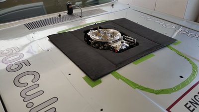

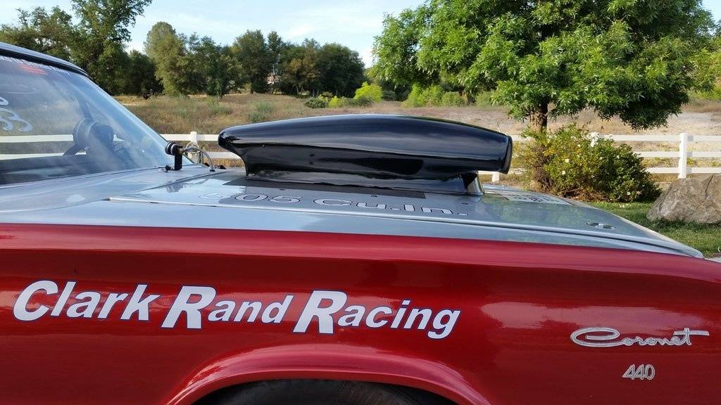

Even with the dominator, it's still going to need hood space. My scoop is 4.250" at the front and it catches a huge amount of air. I don't have hood pins and the latch will slip in the adjustment slots every pass. I have now bolted the latch solid in place to the hood structure and now after a pass the hood is not sitting flush like when you close it, it's up along the cowl and right side. I read that a fellow actually gained 3mph by going with (dare I say it) a cowl hood.. But it will be interesting to see the diff between the 440-25 and the Super Victor and Dominator on the 505 I'll be sure to share.

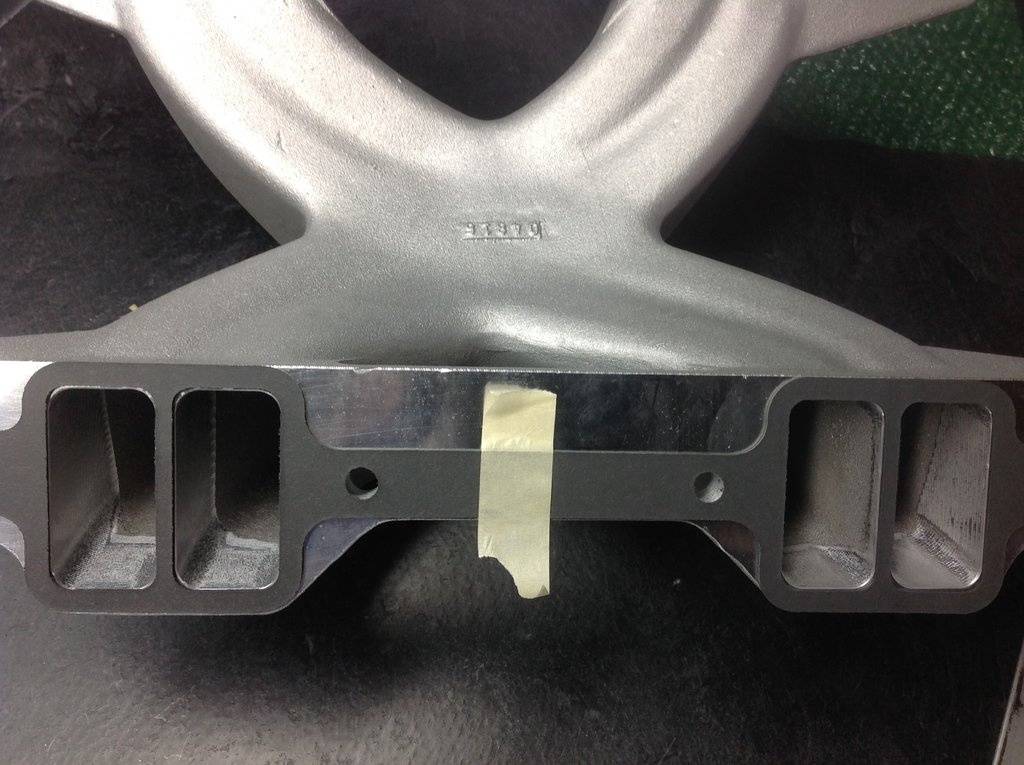

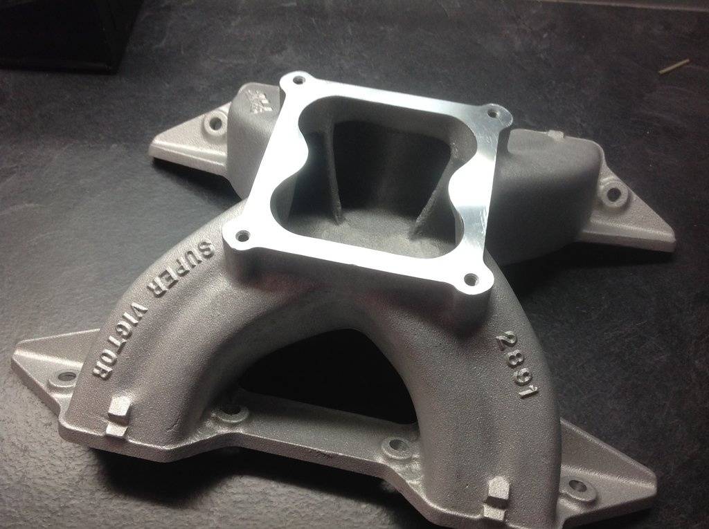

Regarding the Super Victor #2893 intake it's strange that the part number says 2891 on it. The box says 2893, it is max wedge ports, for a 4500 series carb and you can see where the ports have been milled.

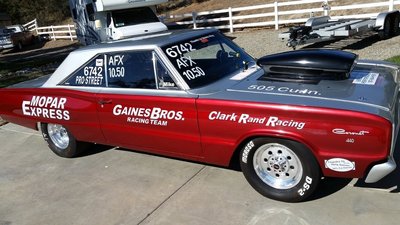

I needed clearance for my INDY Dominator Single Plane Intake with 2" spacer and 1050 Carb so bought a Pro Stock Style Scoop and bolted it on. It serves its purpose and I believe it catches less air (and therefore less "drag") than the really tall hemi style scoop that you have Malex (although I would still trade you cars in a heartbeat, lol).
FOOD FOR THOUGHT
I expect there to be very little difference either way, if at all, between the 440-25 with 750 Eddies compared to the Super Victor with a 1050 Dominator. This is on a 505. Probably the biggest difference will be the weight.

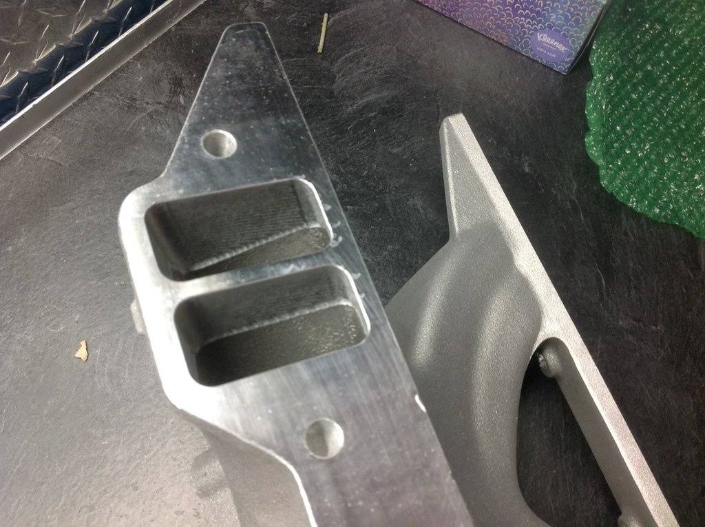

View attachment 441208 View attachment 441207
Was that intake purchased NEW from Edelbrock and came like that ?
