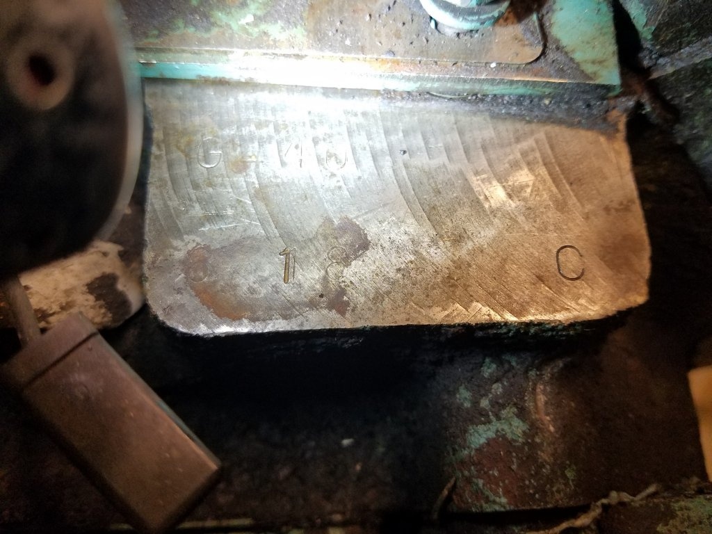

There should be numbers stamped on the flat pad near the distributor.
Besides the possible "HP", there should be a letter code for a year.
The "HP" indicates a few extra high perf parts from the factory that likely have been removed/replaced by previous owners.....the date code will tell you what the factory compression ratio was, which is a lot more of an expensive proposition to change.

in the car itll be hard to see the vin stamp on passenger side oil pan rail. ya the Vin stamp will only maybe give you a hint what it was in. so youd know when it was made and what plant it was designated for. if it was a plant that made roadrunners, satellites and belvederes, and has the hp stamp, thats a good chance it was a roadrunner, obviously not a belvedere. but one other hint as to what it was in, like on my motor, if it has a C instead of an HP, it was used in a C body. and designated for a c body plant. anyways theres ways to give you a clue, but no garuntee, unless you have a numbers matching car to directly compared it to, but like others said, any 440 is a good 440, and any 440 is better then no 440 thats for damn sure. all 440s are good to build to 500hp with zero worries. more then that 6 pack rotating assembly is a plus, thats why RV 440s from the later 70s are great canidates. RV sometimes have low miles. put nice heads, higher compression pistons and you have a sweet motor with minimal labor or machining.

"C" is NOT a C body- it is a year code.

sorry sir, but your only half right. C can be a date code, but only if its up top, right before the 440, a big Capital C in the bottom right where HP would normally go indicates it is from a C body. my date code on my 440 is a G indicating its a 71.
and my oil pan rail stamping 1C269777, shows jefferson road plant code and jefferson road ONLY built c bodies

I should have been clear that the date letter should be before the "440".
I had never heard it either. I had emailed andys440 to ask bout a big *** sideways z on my fendertag (a weird lynch road thing) and asked Bout the c as well. Either he really know his stuff or has alot of good literature.
