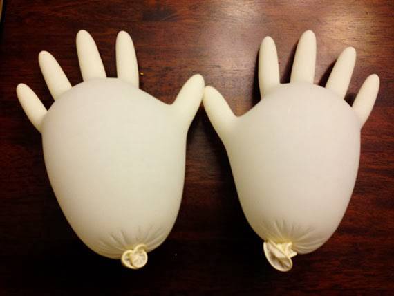

You know those funny looking balloons? If you let the air out, you can actually fit a hand inside them and your hands stay clean. :)

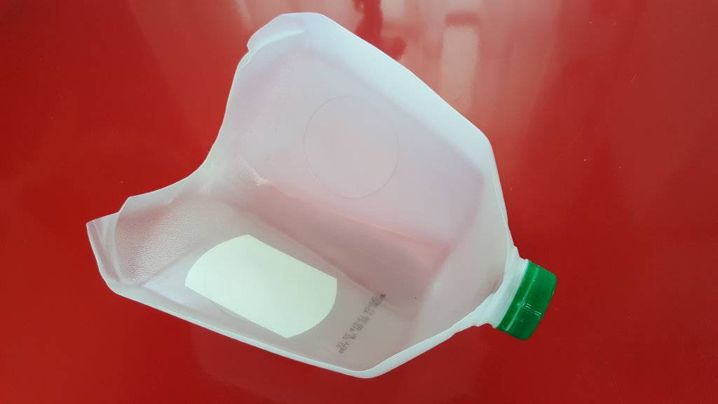

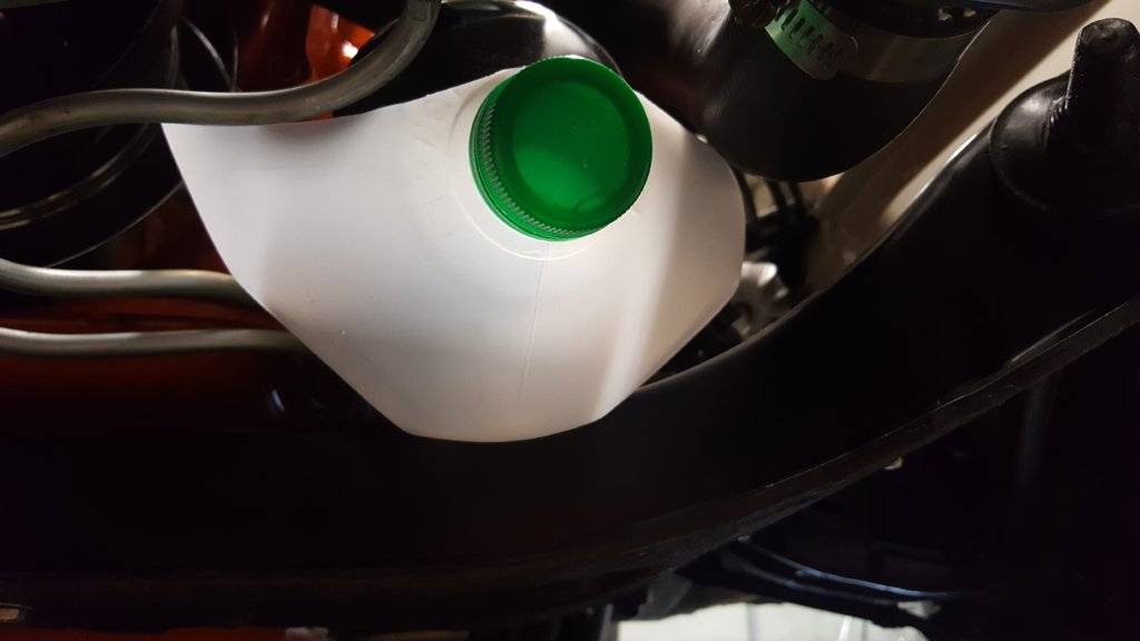

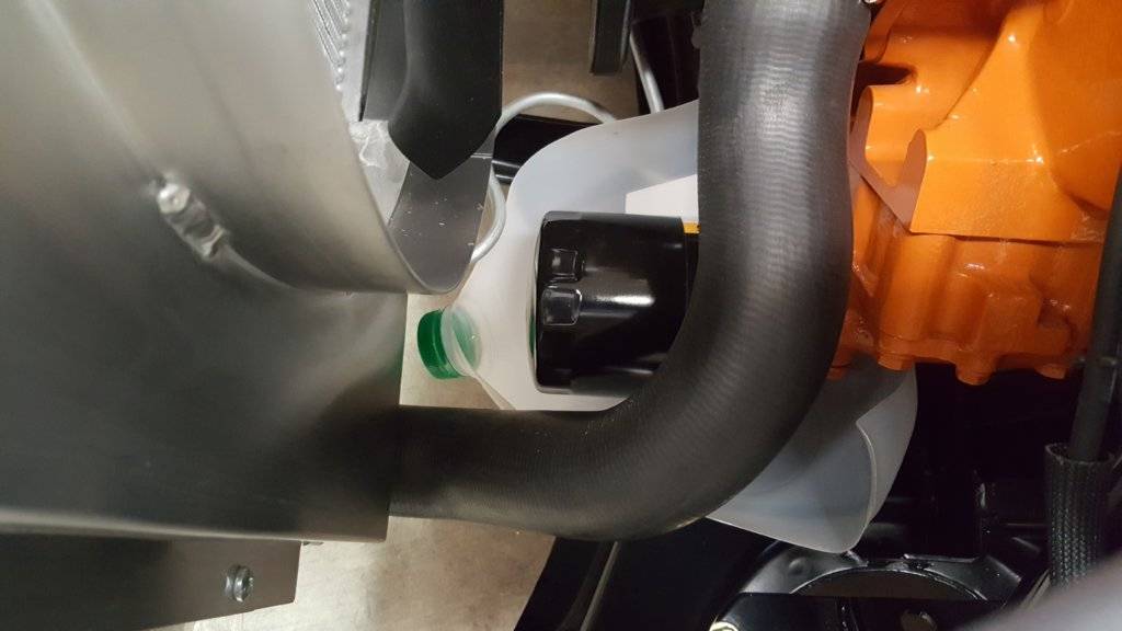

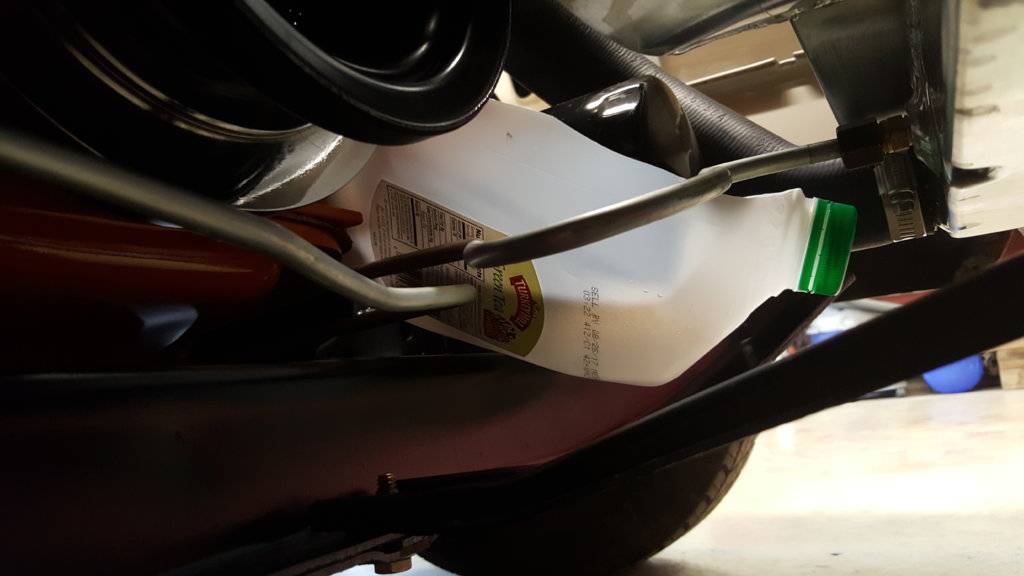

I've posted this on another thread but it fits here also.
Take a gallon jug and cut it lenth ways. Cut the bottom in a curve to hook behind the filter. Loosen the filter enough to be able to spin it by hand then insert your modified jug. Keeps the oil from going all over the K frame.
Good idea, khrylerkid. I had something of the nature, years ago, I used. Going to make up a new on...keep it in the trunk, pull it out when needed. Hate a oiled down k-frame, and wiping it down.
