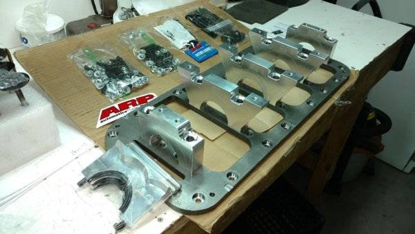

Yes, i'm gonna do a stroker and yes i'm using 7.10 rods. My 440 block is being sonic checked right now, if the walls are .300 thick I'm gonna bore it .055 or .060 over and do a partial block fill (3/4 inch) I just got my BRC girdle kit with billet main caps for it also. Should be pretty stout . . . crossing my fingers on the cyl wall thickness.

Yes, you are correct BCR, not BRC. Here it is, I got their billet seal retainer too -
