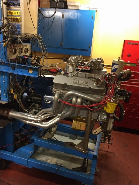

So some initial dyno numbers. Have established a base line now @ 34 - 35 degrees advance. Got to get into fine tuning so there is probably some more power to dig up
653 TQ @ 4700. / 707 HP @ 6250. Darn main seal is leaking though so it's a little messy.. Hopefully we'll see a little more out of it with jetting and valves.
Stayed tuned.
View attachment 393791 So some initial dyno numbers. Have established a base line now @ 34 - 35 degrees advance. Got to get into fine tuning so there is probably some more power to dig up
Stayed tuned.
Stayed tuned.
Nice baseline it is too :thumbsup:
look forward to seeing what you get when done tinkering/tuning
good luck & Happy Moparing

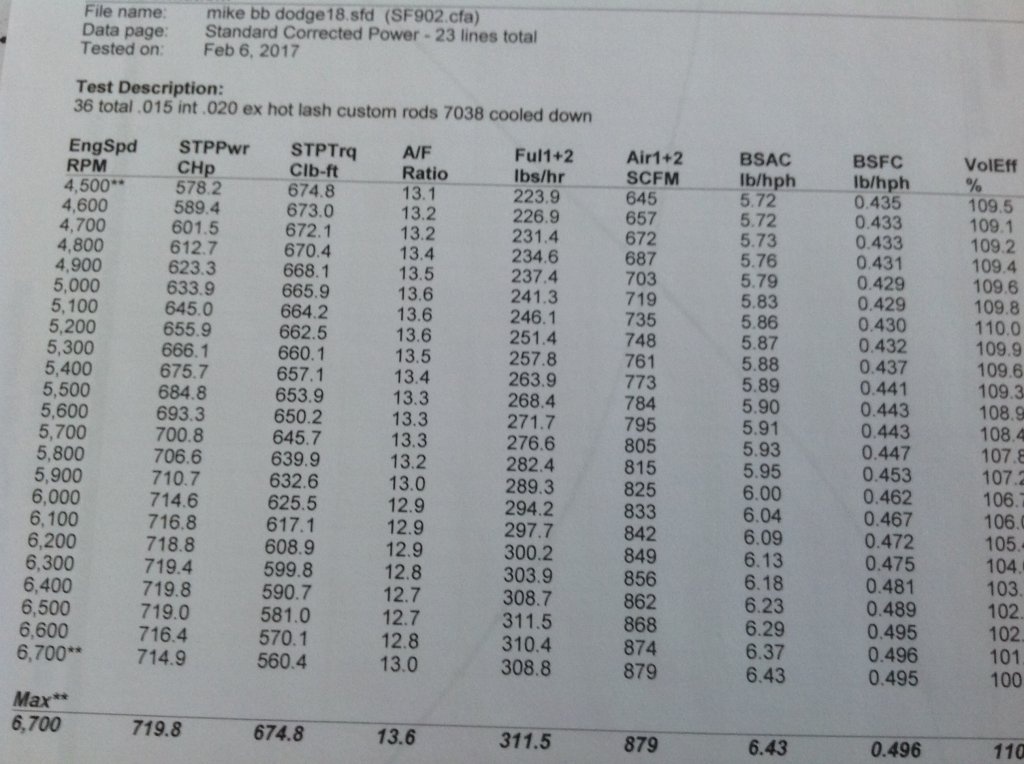

Dyno day went well. The 505 ended up making 720HP @ 6400 and 676TQ @ 4500. Without a doubt we could have pulled more power out of it but we were limited to jets and metering rods.
A pretty good day on the dyno.

Both Superstock and DVW must have crystal balls cause they had this combo pegged pretty well dead on! These guys are the real deal, that's for sure.
Here's one of the print outs from the day. Some nice flat lines it seems.

Thanks Superstock! You pretty well had it pegged bang on. Doug predicted over 700 too. Thanks again for sharing the knowledge!
