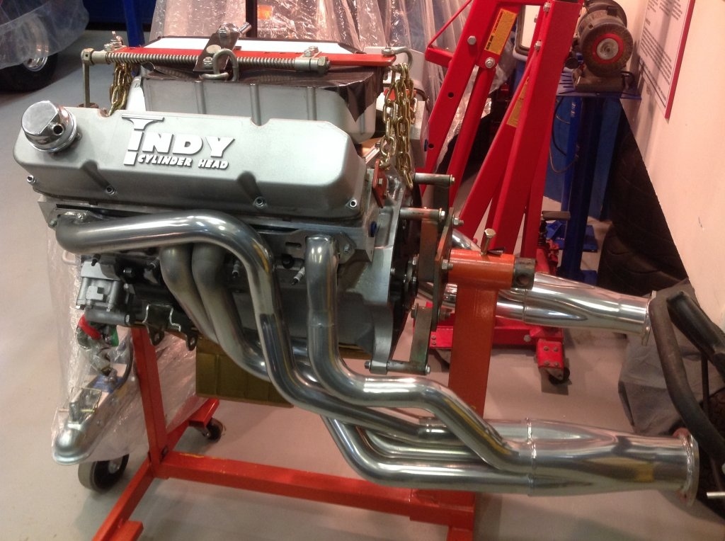

With the dyno tests earlier this week and that leaking rear main seal the headers really took a beating with the oil getting thrown around and baked on. Many runs up past 6700.
Got to say that the TTI headers with the ceramic coating are excellent. With some elbow grease and a metal polish they cleaned up well! It was a good choice to go with TTI.
Regarding the rear main seal, a new one is in place and some mods to the seal retainer were made. I expect to have a fix. One thing that I did different was install the seal ends at 6 and 12 oclock. When dropping the retainer over this way it tells you where the retainer needs to be.
