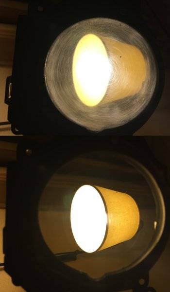

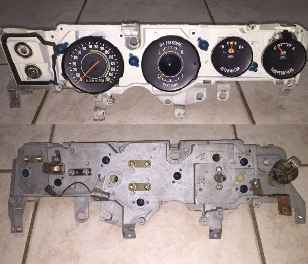

A couple pictures of my work 2 years ago. The lenses are before and after polish. Just used a plastic polish on a power drill w/buffer.
Blue Magic works real well. It won't scratch. Get the paste in the tube. Works well on glass also.
I just used the 3M headlight restore kit, turned out pretty good!
I would have to agree with Dangina, I used the 3M headlight restorer kit and they seem to be fine. A cheaper option would be the TurtleWax version. Might be a cheap fix until you can track some down!
I have to say it again... toothpaste ;)
