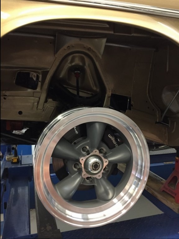

Have to drop the rear hangers to get the rear wheels off, saves prying them out between the wheel lips and rotors.

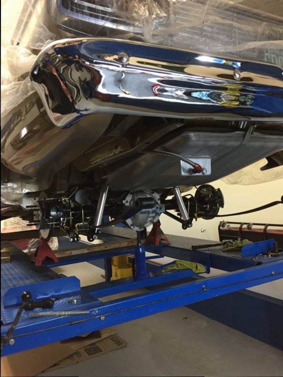

Double acting shocks, chose to have the knobs pointing outward to eliminate risk of them possibly catching the bump stop brace. Lots of fine tuning ahead.

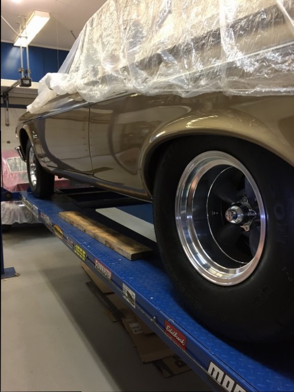

Vintage Torque Thrust wheels sure aren't the lightest rim out there but the look makes up for the additional lbs.

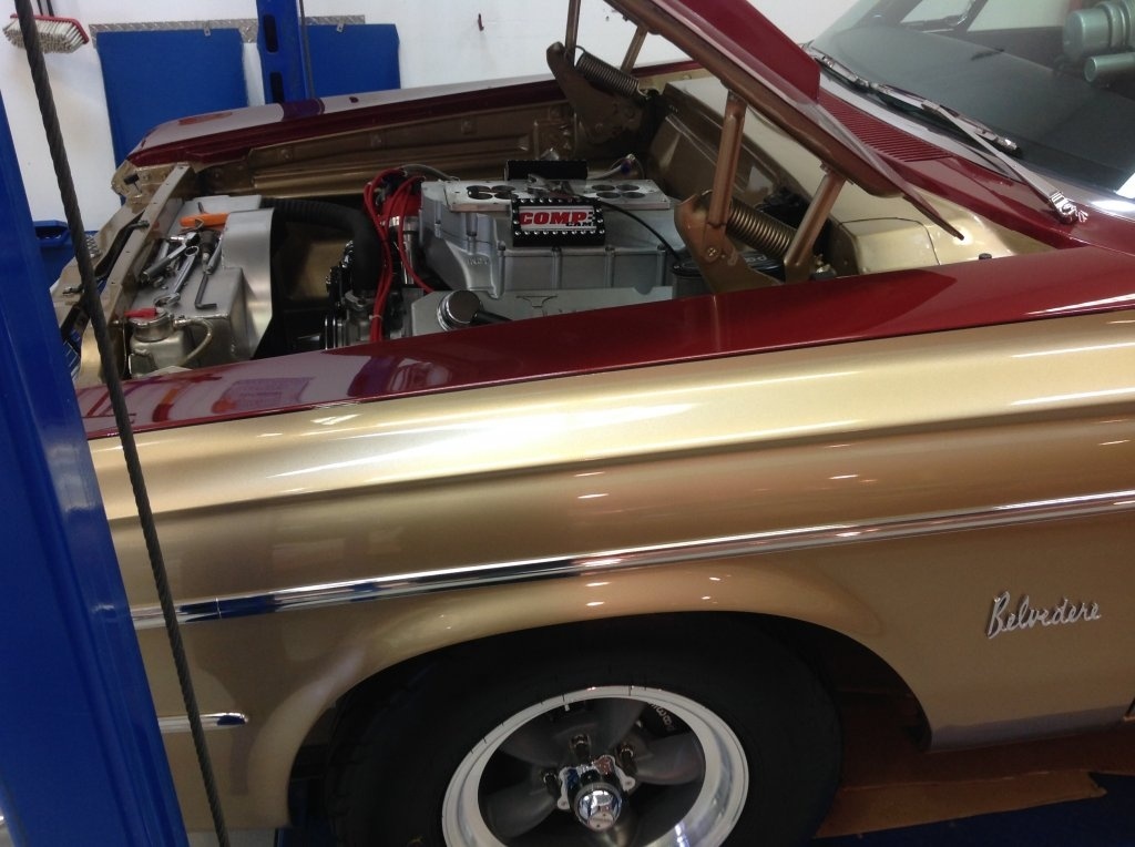

Eddies off for a different jet / metering rod combo - courtesy of Superstock and DVW. Thank you.
Side shot with the new wheels.

Love it . Awesome build, very meticulous and clean. Just the way I build my cars.... What are the comp cams boxes on the sides of the intake ?

Thanks for the compliment BEE. Those are burst valves. These big old intakes like to pool fuel and backfire, sometimes damaging the intake. I've had My share of backfires as well. Although, since locking out the distributor when on the dyno it's been 100%.

I plan on having 5 gallons in it per run. I'm not expecting any problems but have an interior fuel pressure gauge and I'll be keeping an eye on it.
Now if I was to scrape the tank sump on the track on launch that wouldn't be all that bad neither.. :)

I run my 68 sumped like that . Start day at 10 gallons .
I think you may be a little faster though

Thanks Tex. Riverdawg will like your info on the sump, he was wondering. Mike Gaines had mentioned that each run he makes he has the same amount of fuel in his car. Makes sense and I plan on doing the same.
