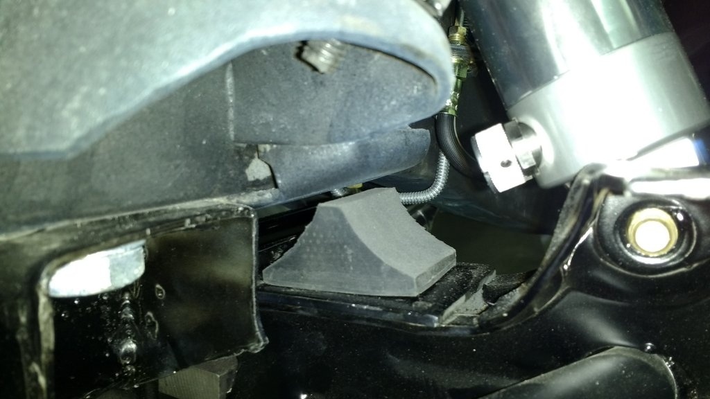

I was looking at picture #2 in post #1, are you missing a cotter pin on the lower castle nut?
Only one thing to say....FABULOUS CAR......
Mike, thanks for the compliment! Appreciate it. You've sure gotten your Coronet running well. Surpassed your goal and then some. Very impressive.
Hi Hoser! Yes, both front spindle bolts, there's no cotter pins. The rear spindle bolts have no provisions for cotter pins so I have all of them locktited. You make a good point though, Someone at tech could have issue and insist cotter pins so I'll take care of that.
Hope your not upset I pointed it out. I welcome stuff like that, that will save me some possible grief latter.
Hope your not upset I pointed it out. I welcome stuff like that, that will save me some possible grief latter.[/QUOTE. It was a nothing thing anyways.
Actually it's kind of funny. Last week we were talking about shocks when I was asking you about clearance with the adjusters. I noted in your post that your lower ball joint didn't have a cotter pin.
Yep, I'm waiting till it's on the ground to torque everything. Hopefully soon. Great minds think alike!

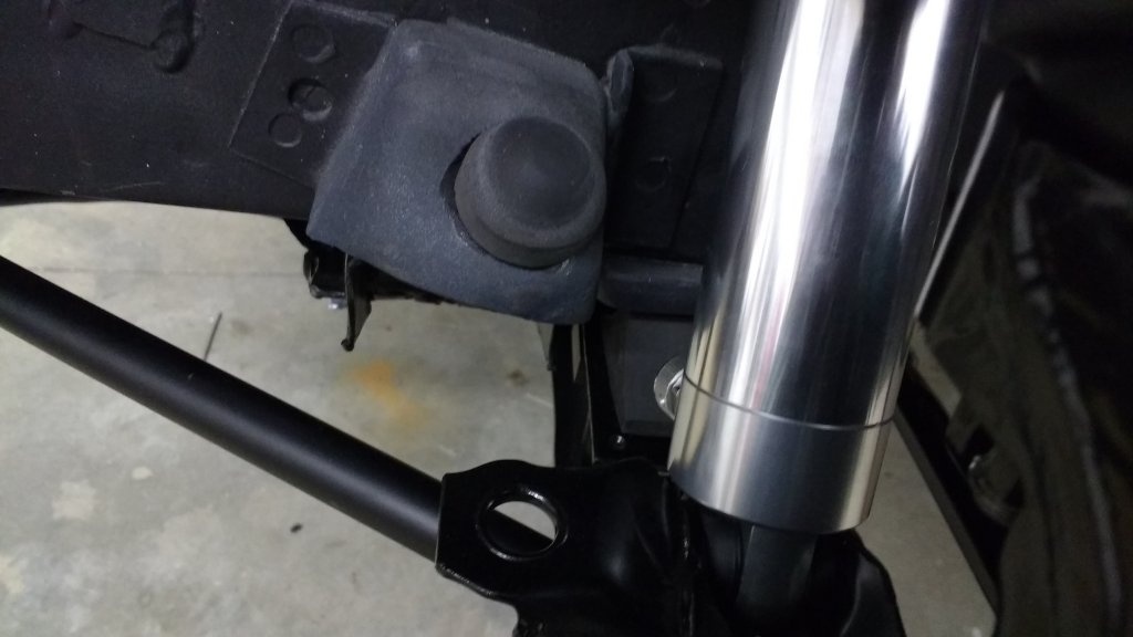

Malex, I backed off the torsion bars and compressed my front suspension to see what I had for clearance on the shock knobs. Plenty of room.
I thought I had checked it but doesn't hurt to double check. Racing this weekend?

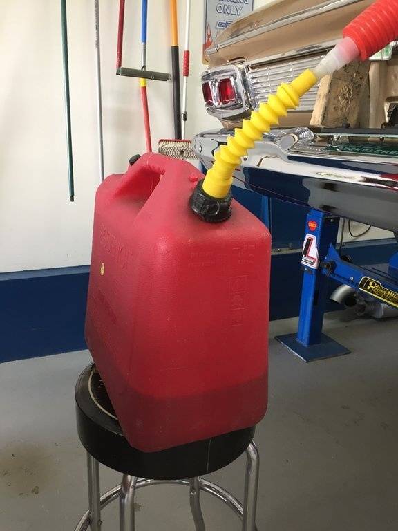

While I was researching a good pump to purchase I read that fuel tanks with sumps must run no less than 1/2 tank of fuel to eliminate cavitation. I decided to empty my tank to find out the amount of fuel I was running with and found the reason the Plymouth was not feeling quite right... Another thing I found is my converter is draining back as the fluid level is way over full now and the shift lever seal is seeping. Will need to read up on the drain back issue or if you guys have advise please share. It doesn't leak until it's been sitting for a day or so.

This is how much fuel was in my tank when it's at 1/4 on the gauge. Needless to say my fuel problem was my own doing. So much for assumption. I put the fuel back in and another 5 gallons added. 5/8 tank now and should be good. We'll find out soon enough.

Thanks 69. Yes my fuel issue was my own fault. I took for granted that a 1/4 tank would likely be about 4 gallons and with the added sump, no issue. I blew that one.. Easily fixed though and it likely saved me a warning that day.
