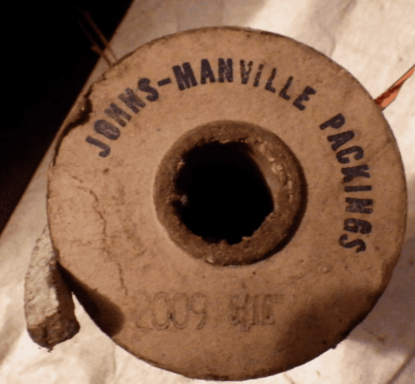

I think Mancini has rope seals. FYI you can't install a rope seal without removing the crank first. The two piece lip seal can be installed with the crank still in place. If the engine still has the rope seal and you want to install a two piece seal without removing the crank, you're going to have to "work" to dig the old one out!
https://www.ebay.com/i/282433611363...3D711-117182-37290-0%26rvr_id%3D1389965590763
Yup....and anyone who has ever worked in a refinery (or anywhere pumps are used) that installed packing type sealing knows how to do it. Now a days, 99% of pumps use mechanical seals but in the 80's, 90% of them used packing or rope sealing. Mechanical seals are an EPA mandate too and imo, it was one of the few good ones.
