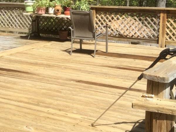

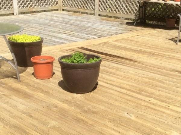

As 69L48Z27 said GPH+PSI. I bought a 13 hp x 4GPM to clean my deck yearly. Deck is 1100 sq ft and takes 5/6 hours to do. You can see the difference, need to be careful, it WILL rip the skin off you instantly. If your cleaning a deck 45 degree nozzle and start 3 or 4 inches away. Move wand closer to surface and sweep across board and before you stop sweeping move it away from surface. If you stop it close to surface you'll have a stop mark. My deck was black in areas from oak sap. I have no experience with soap injectors to cut grease. Gunk pretreat? Environmental problem?
Edit: Had gallons per hour should per minute. If your p washer is say 4 gpm make sure water supplied to wash is more than 4 gpm!

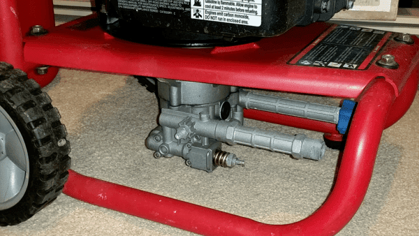

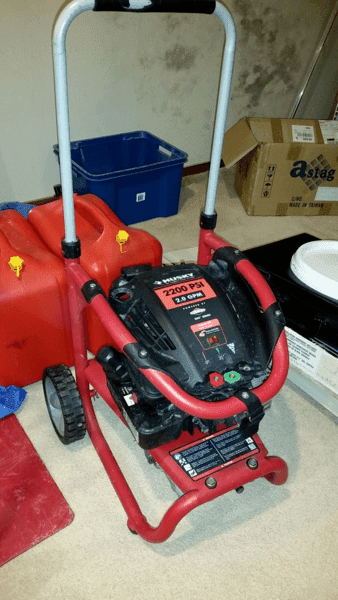

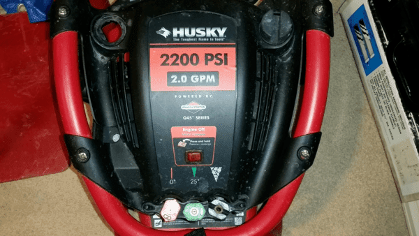

Here is my Husky with a Briggs & Stratton motor - has been extremely reliable to me....even lent it to my brother a couple of times. I recently bought 2 x extra 8m (25ft) hoses and extension couplers....for washing the upper levels of my parents house early next year. my buddy sourced this from HF I think - or Sears...about 6-7 years ago and it cost me around $400. For the use I have had with it, this is a great price.
The only thing I had to do was adjust the spring clips that hold the wheels on - they would vibrate off after an hour or so.
