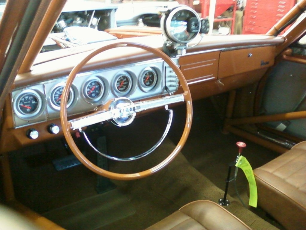

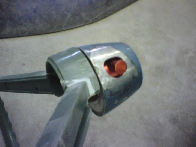

I used Plexus, then Bondo. Ground the cracks wide down to the metal core. It's holding up well, year 5
Doug
Beautiful work, dvw!
X2! Looks great!
