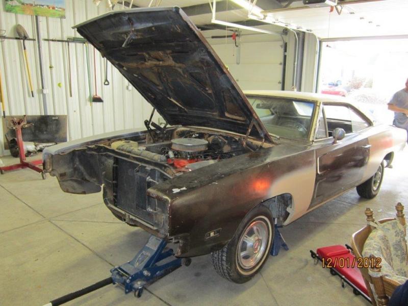

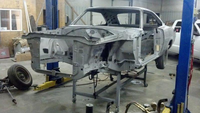

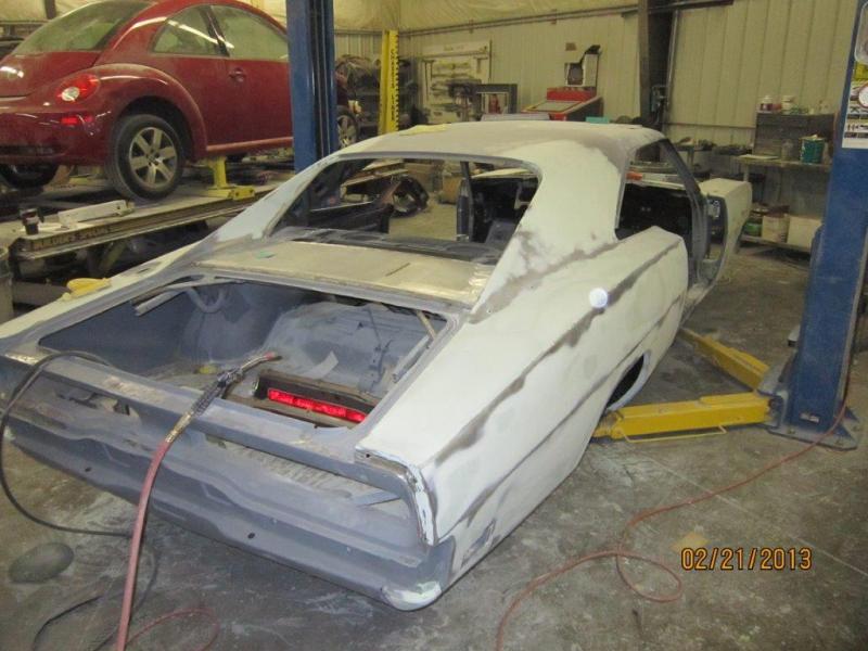

Well I appreciate all of the input and after a lot of diliberation (and consulting my pocket book), I do agree and do not want the GM stuff on my Mopar!!!!! I am going to do more discussions with James at PST to get a better understanding of what they offer versus the Pirate Jack's offering of the same type of brake booster (http://www.piratejack.net/index.php?page=shop.browse&category_id=49&option=com_virtuemart&Itemid=6). Has anyone did some comparisons? Well, it has been suggested that if I do not submit pics of my project I would basically be subjected to a witch hunt..... so here you go! Hopefully sometime this summer I will have it up and driving! Then I can post more! In Order... Preparing for bodyshop, stripped all paint, checking for fit and hidden rust, paying attention to detail including body lines, etc...... Thanks again for everyones assistance!!!

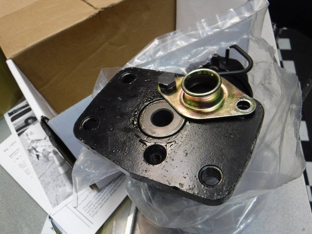

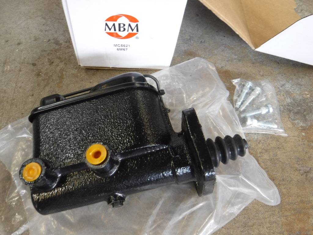

Here it is 2017! Pirate Jacks... I gotta say, we are having problems with correct parts that we never had when buying from Just Right... among other wrong parts received and returned to get the correct parts, we received MBM MC-5621 a master cylinder (with removeable rubber boot) on the male end of a brass colored plate holding the master cylinder internals under pressure - Pirate Jacks says this unit is interchangeable and instructs us to unbolt that plate! we show the brass colored plate in photos swivelled and we see no lock washer holding everything if I remove that plate... I wanted to ask... someone... What will happen if I unbolt that brass plate to install the master cylinder to the booster minus plate? RE: part number MBM MC-5621, a master cylinder supplied with kit DBK6272 using BCK8536-1 booster/master cylinder build for 1968 B body? This unit does not have a lock washer holding the internals like we are used to seeing supplied... Thanks. (I think it will implode, rending it useless?)
That piece on the master is for manual brakes. I just changed my Master cylinder and it had a tear drop washer on one bolt to hold the pistons in. Good luck I'm also interested in disks for the front but already have power drakes. Following!
Updates! Super unhappy. Our shop was confused by this male brass plate, the same one that Pirate Jacks said to remove. In our history (3 decades) we've never seen this to be true, but low and behold! TRUE, according to Pirate Jacks returns department. Attaching a photo here of how Pirate Jacks helped us. This 17 pound parcel (a return to us of our returned product) box came apart somewhere in the travels, product lids are smashed, both of them... Not the end of the world... Will get those somewhere else. We instructed Pirate Jacks that someone in the returns department needs to be fired. They received our two individually packaged, double walled boxes, insured and sent priority (over $80 paid by the office so the items could arrive in excellent shape so they could easily resell the product we returned) then removed the brass plates, threw these same units in one thin walled priority box and sent it back to NAMC. Wow. Just..... Wow. "Just Right Brakes" from now on. ~peace out!
That sure is sad, the piston looks like it's coming out too. On power brake Master cylinders a tear drop shaped washer holds the piston in. The closest thing I can use to describe the washer is the marker used by google maps to pinpoint locations on the map. That shows a lack of pride in the job, a sight all to common these days unfortunately.
Our office received a really nice apology letter from Pirate Jacks after we reported in with a complaint about the return debauchery. They agree'd that the return was not handled well and said changes will be made from the factory to better explain the dual use of this one unit. They offered to resend two more units to replace the ones poorly packaged which resulted in damage... WE just dont believe it's the right unit to begin with, so we are done. Looking elsewhere for the fixes/replacements. My hope it that they can learn from our poor experience and make things better/easier/faster for their next customer. Unfortunately the next customer will not be us. Peace Out!
